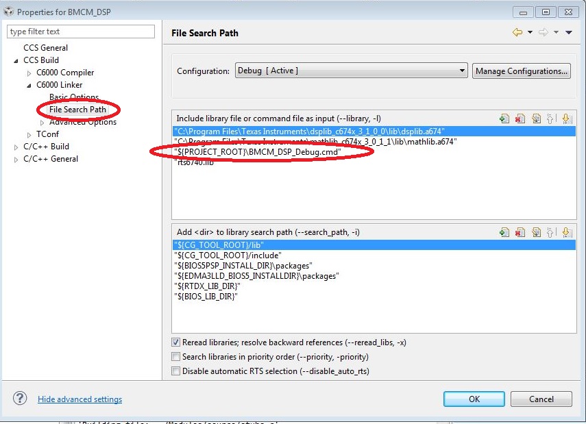

  • Ok, so I did some more experimenting. It feels like the solution is really close.
    These three lines work when I put them at the end of my .cmd file.
    sym1 = 0xAAA;
    sym2 = START(SDRAM);
    sym3 = END(SDRAM);
    They all get a warning however. Company policy is restrictive with writing code that generates warnings, so I would like to understand what is going wrong. Here is the description.
    Description    Resource    Path    Location    Type
    #10190-D     BMCM_DSP_Debug.cmd    /BMCM_DSP    line 37    C/C++ Problem
    When I try to modify the lines that I have above to solve my problem, my guess would be the following two lines:
    ___far__ = START(.far);
    ___farEnd__ = END(.far);
    Unfortunately that doesn't work at all. Both lines result in the following errors:
    #10345-D     BMCM_DSP_Debug.cmd    /BMCM_DSP    line 35    C/C++ Problem
    #10345-D MEM_START(.far,0) has either    BMCM_DSP_Debug.cmd    /BMCM_DSP    line 35    C/C++ Problem
    And another warning of the same type as before:
    #10190-D     BMCM_DSP_Debug.cmd    /BMCM_DSP    line 39    C/C++ Problem
    Any new suggestions?
    Johan

    The funny thing about the error messages is that I do only define the global symbol ___far__ once, and I don't use the DOT operator anywhere. But as you point out the error messages indicates something else.
    So in my original command file I have the following two definitions for the .printf section
    .pinit:                > SDRAM
    and a bit further down the list there is
            GROUP {
             .const: align = 0x8 {}
             .printf (COPY): {}
            } > SDRAM
    When I try to remove the first one I get the following result:
    "../BMCM_DSP_Debug.cmd", line 45: remark #10191-D: object ".printf" is not
       allocated, but is being placed as part of allocated object "GROUP_1"
    "C:/SVN/TEBS/SW/4011_Dooku/BMCM/DSP/Trunk/application/Implementation\BMCM_DSP_Debug.cmd", line 45: remark #10191-D:
       object ".printf" is not allocated, but is being placed as part of allocated
       object "GROUP_2"
    And when I remove entry inside the group statement it seems to link without warnings. But isn't the .printf (COPY): {} statement inside the group definition there for a reason?
    So, when I rewrite my command file to look like this:
            -l"ti\pspiom\platforms\evm6747\lib\Debug\ti.pspiom.platforms.evm6747.evmInit.a674"
    -l"ti\pspiom\spi\lib\C6747\Debug\ti.pspiom.spi.a674"
    -l"ti\pspiom\i2c\lib\C6747\Debug\ti.pspiom.i2c.a674"
    -l"ti\pspiom\psc\lib\C6747\Debug\ti.pspiom.psc.a674"
    -l"ti\pspiom\gpio\lib\C6747\Debug\ti.pspiom.gpio.a674"
    -l"ti\sdo\edma3\drv\lib\Debug\edma3_drv_bios_c674.lib"
    -l"ti\sdo\edma3\rm\lib\c6747\Debug\edma3_rm_bios.lib"
    -l"ti\sdo\edma3\drv\sample\lib\c6747\Debug\edma3_drv_bios_sample.lib"
    SECTIONS{
            .text:                 > SDRAM
            .switch:             > SDRAM
            .bss:                 > SDRAM
            .far:  RUN_START(___far__), RUN_END(___farEnd__) > SDRAM
            .cinit:             > SDRAM
            .pinit:                > SDRAM
            .printf:            > SDRAM
            .data:                > SDRAM
            .cio:                > SDRAM
            CalDataCfgFLASH:    > SDRAM
            CalDataFLASH:        > SDRAM
            CalDataSpecFLASH:    > SDRAM
            .buffers:            > DMA_ACCESSIBLE
            GROUP {
            } > SDRAM
    It still gives this result in the build console:
    'Building target: BMCM_DSP.out'
    'Invoking: C6000 Linker'
    "C:/ti/ccsv5/tools/compiler/c6000_7.4.4/bin/cl6x" -mv6740 --abi=coffabi -O1 -ms1 -g --define=DSP --display_error_number --issue_remarks --diag_warning=225 -z -m"BMCM_DSP.map" -i"C:/ti/ccsv5/tools/compiler/c6000_7.4.4/lib" -i"C:/ti/ccsv5/tools/compiler/c6000_7.4.4/include" -i"C:/Program Files/Texas Instruments/pspdrivers_01_30_01/packages" -i"C:/Program Files/Texas Instruments/edma3_lld_01_11_02_05/packages" -i"C:/ti/bios_5_42_01_09/packages/ti/rtdx/lib/c6000" -i"C:/ti/bios_5_42_01_09/packages/ti/bios/lib" --reread_libs --warn_sections --xml_link_info="BMCM_DSP_linkInfo.xml" --mapfile_contents=sym_defs --rom_model -o "BMCM_DSP.out" -l"./BMCM_DSPcfg.cmd"  "./Common/BCPBalancingManager/source/BCPBalancingManager.obj" "./Common/CommonBase/source/FloatVectorOp.obj" "./Common/CommonBase/source/ChkSum.obj" "./Common/CommonBase/source/BitVector.obj" "./Common/Hal/source/SpiDrv.obj" "./Common/Hal/source/I2cDrv.obj" "./Common/Hal/source/Gpio.obj" "./Common/Hal/source/EEpromHndl.obj" "./Common/Modules/source/state_estimate.obj" "./Common/Modules/source/sop.obj" "./Common/Modules/source/soh.obj" "./Common/Modules/source/matop.obj" "./Common/Modules/source/error.obj" "./Common/Modules/source/ekf.obj" "./Common/Modules/source/cell_param.obj" "./Common/Modules/source/cell_ocv.obj" "./Common/Modules/source/cell_model.obj" "./Common/Modules/source/cell_main.obj" "./Common/Modules/source/NVRamMgr.obj" "./Common/Modules/source/MCUMgr.obj" "./Common/Modules/source/ErrHndlLight.obj" "./Common/Modules/source/CellWrapper.obj" "./Common/ProjectBase/source/YodaParentProjectInherrited/TEBS_TECAN_protocol.obj" "./Common/ProjectBase/source/YodaParentProjectInherrited/SeedKey_protocol.obj" "./Common/ProjectBase/source/YodaParentProjectInherrited/MCU_ICU_protocol.obj" "./Common/ProjectBase/source/YodaParentProjectInherrited/MCU_DSP_protocol.obj" "./Modules/source/main.obj" "./Modules/source/lut_param.obj" "./Modules/source/lut_ocv.obj" "./Modules/source/DSPCalSpecData.obj" "./Modules/source/DSPCalData.obj" "./Modules/source/DSPCalCfg.obj" "./Modules/source/CalData.obj" "./BMCM_DSPcfg_c.obj" "./BMCM_DSPcfg.obj" "../BMCM_DSP_Debug.cmd" -l"C:\Program Files\Texas Instruments\dsplib_c674x_3_1_0_0\lib\dsplib.a674" -l"C:\Program Files\Texas Instruments\mathlib_c674x_3_0_1_1\lib\mathlib.a674" -l"C:/SVN/TEBS/SW/4011_Dooku/BMCM/DSP/Trunk/application/Implementation\BMCM_DSP_Debug.cmd" -l"rts6740.lib"
    <Linking>
    "C:/SVN/TEBS/SW/4011_Dooku/BMCM/DSP/Trunk/application/Implementation\BMCM_DSP_Debug.cmd", line 19: warning #10190-D:
       absolute symbol "___far__" being redefined

  • The problem is that the linker is sees the exact same linker command file BMCM_DSP_Debug.cmd two times in the command line invocation.  It is pretty hard to spot.  So look carefully here ...
    See it?  The first time it appears without any leading -l option.  The second time there is a -l and the full directory path in front of it.  One of them has to be removed.
    The screen shot below shows how I did it.  I changed the build options to remove the one indicated with -l.  On the left I circle where in the build options you see the option.  On the right I circle the name of the option to remove.  Highlight it and click the delete icon to remove it.
    Thanks and regards,
    -George
  • Well done George!
    Everything works as expected after removing the command file duplicate. That was indeed a tricky thing to spot.
    Thanks a ton for helping me out.
    Johan
