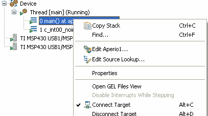

Why the menu item "Disable interrupts while stepping " is disabled permanently in context menu (CCS v4.1.1.00014 )? Of course I can switch GIE flag every time manually, but this feature was convenient for use.
The problem appeared when I installed automatic update to CCS v4.1.1.00014 Core edition couple day back. I have instaled just a MSP430 development tools.

    I also see the issue with that option is no longer accessible. I have filed bug number SDSCM00035402 for the issue.

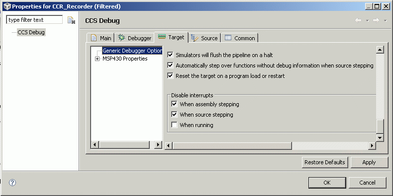

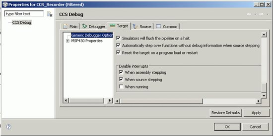

    Regarding the "Disable interrupts while stepping", I was also surprised to find a greyed option. But in fact, this option was multiplied in three : while running, while source-stepping and while assembly-stepping !
    You'll find it in two places :
    - remanent setting :in the project's "Debug Properties ..." => Generic Debugger Options, the three "Disable interrupts" options are the very bottom of the options list
    - temporary setting in a debug session : the menu "Tools => Debugger Options => Generic Debugger Options" is the same as above, but open in a new tab; scroll to the bottom to see the three options ...
    Have fun !
