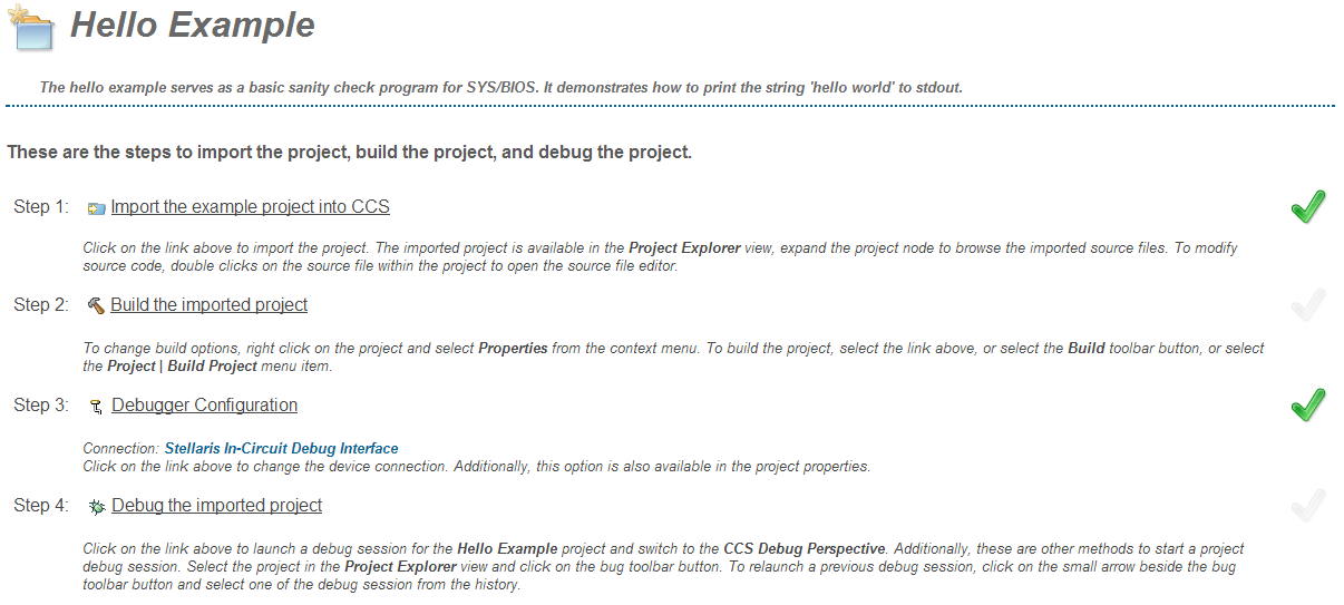

I am having a hard time getting started with CCS v5. I am using a TIVA C - TM4C129XNCZAD Launchpad board. To use as a template, I am first trying to walk through the "Hello" Example provided within CCS. This example gives 4 steps, as shown below. I cannot get step 2 (Build the imported project) to work. When I try to build it I receive the following error(s):
line 51: Error: xdc.tools.configuro: Error: no target named: please use -t, -b, or --cb
As the step 2 instructions suggest, I attempt to change build options. The following 2 screen shots are what I have. Notice that it won't even let me click "OK" until I have specified a "RTSC Target".
What do I need to do to get this example project (or any project) working?

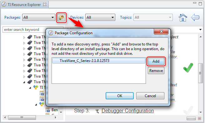

    Just a tip regarding starting with Tiva devices: installing Tivaware is extremely helpful for starters. Despite it does not have the capabilities of a Real-Time Operating System, it interacts with hardware in a good level.
    Tivaware can be added to the TI Resource Explorer (the same tool you used to browse to the SYSBIOS example) by clicking on the button "Add" close to the list of available packages and browsing to where you installed Tivaware.
    Hope this helps,
