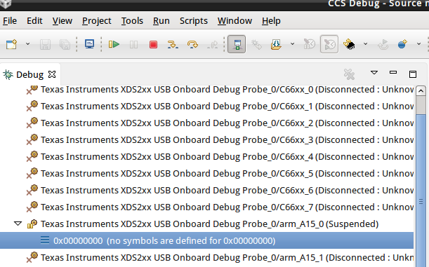

    Now I go a little further on debugging:

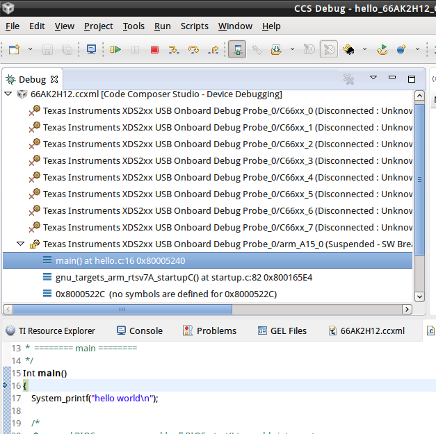

    This time I load GEL file first and then connect ARM_0 (see 1.png). I click 'load' button to load out file here, then arm_A15_0 shows "running" (see 2.png).
    Then I cllck "Suspend" button. The state of arm_A15_0 became original state - "Suspended" (see 1.png).

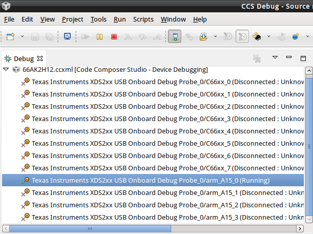

    Then I click "Restart" button, "main() xxxxx" shows under arm_A15_0 and I can also see a cursor point at entry of main() in "hello.c" window (see 3.png).
    I think at this moment the debugging on hello.c is really starting. If I press F6, the cursor move forward for 1 line.
    But what makes me so upset is that if I click "Resume" button the whole thing turns into running state as same as 2.png.
    What else I miss during the whole process?

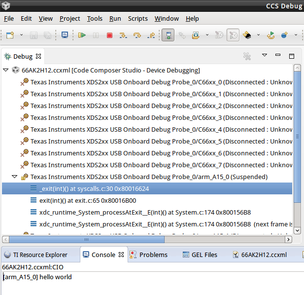

  • Finally, I tried lots of time and main.c could run and the output shows normally, although I really don't know why it works!
    The steps are as follows:
    --connect arm_A15_0
    --load GEL file
    --resume the program (equal to start the program)
    The program runs to the end normally!
