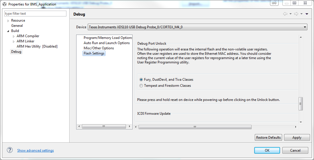

When I choose XDS110 as debug tool, the "unlock" is not shown in CCS configuration
and, I cannot find unlock function in "Uniflash" online tool.
Is there any tool which I can use XDS110 to unlock flash?
    What version of CCS are you using? The reason is that in my CCSv7.2.0, CCSv7.3.0 and CCSv7.4.0 the buttons show ok to me.
    I am using the following component versions (you can check them under menu Help → Installation Details)
    CCSv7.2.0 uses TI Emulators component version 7.0.48.0, while CCSv7.3.0 and 7.4.0 use version 7.0.100.1
    All versions use the Tiva C/E Series ARM MCUs version 2.1.1.15071
    If you have an older version, please try a newer version of CCS (you can install many version in parallel). If not, perhaps something is missing from your setup or it is a glitch of the interface. Check sections 4 and 6 of the Troubleshooting page below:

  • Hello Rafael,
    The version I used is v7.3.0.
    I think the page you post can be shown when the CCS with connection status with target.
    But my target has already locked by existed code, so I cannot enter this page.
    is there any way to find unlock operation page without connection.
    Many thanks,
    Way
  • Way,
    I see now the issue. You can manually launch the debugger and, without connecting to the TM4C core, try to see if the options show up.
    Otherwise, you can try to issue a command similar to what is shown in this post.
    dbgjtag -f @xds110 -Y unlock,mode=tiva
    The command above can be run from a DOS command prompt at the directory ccsv7/ccs_base/common/uscif

  • Hello Desouza,
    Many thanks to your detail explanation. I can find the "unlock" button.
    My new problem is that I cannot unlock my device. However, if I use  Stellaris ICDI, it works.
    The follow message I got when I hold reset pin before power and then press "unlock",
    CORTEX_M4_0: Starting Debug Port Unlock operation...
    CORTEX_M4_0: Error: Failed unlocking device!
