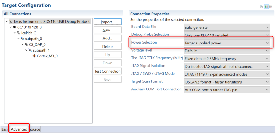

    If your intention is to provide power to the device through a different power supply, then change the configuration setting to "Target Supplied Power" as highlighted below:

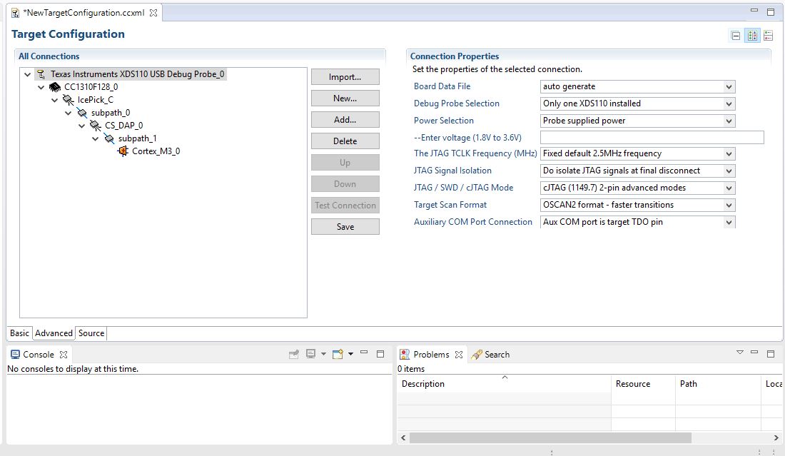

  • Hi Rafael,
    Thanks for your response. Tried both "Target Supplied power" and "Probe supplied power" while providing power supply and removing power supply to the custom board respectively. Debug probe still not working. Attaching snip of the process. Please look for grayed out "Test Connection".
  • Apurva,
    One detail: the Test Connection button is only active when the configuration is saved. Your is not (I see a small asterisk near the filename, which indicates unsaved changes).
    Apart from that, the "Probe Supplied Power" setting requires entering the desired supply voltage in the box immediately below.

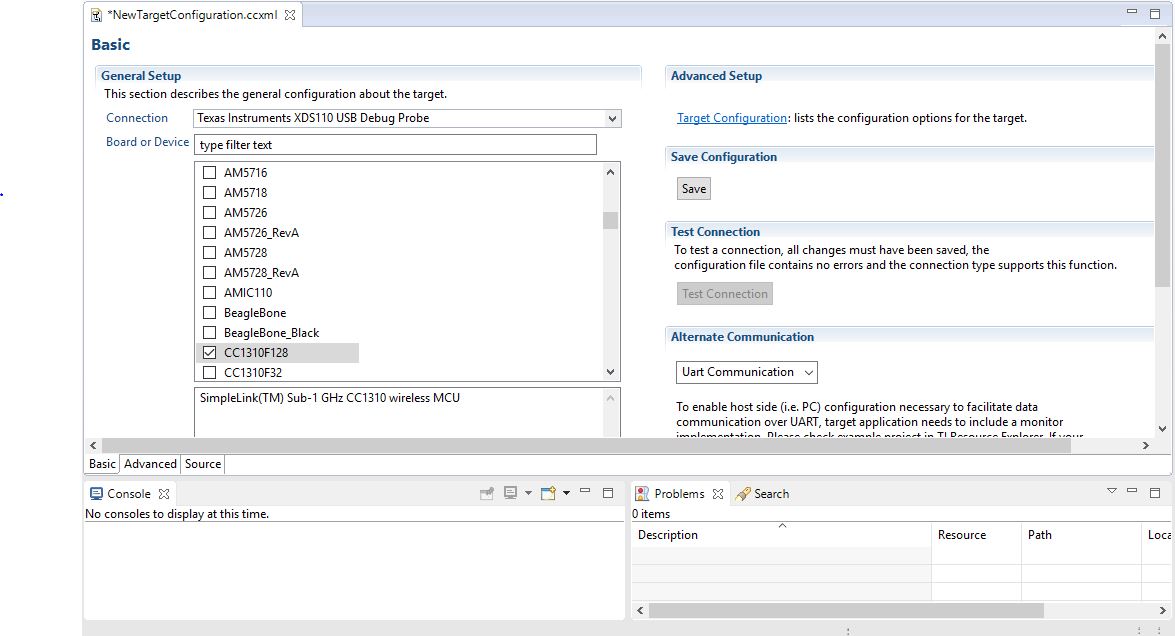

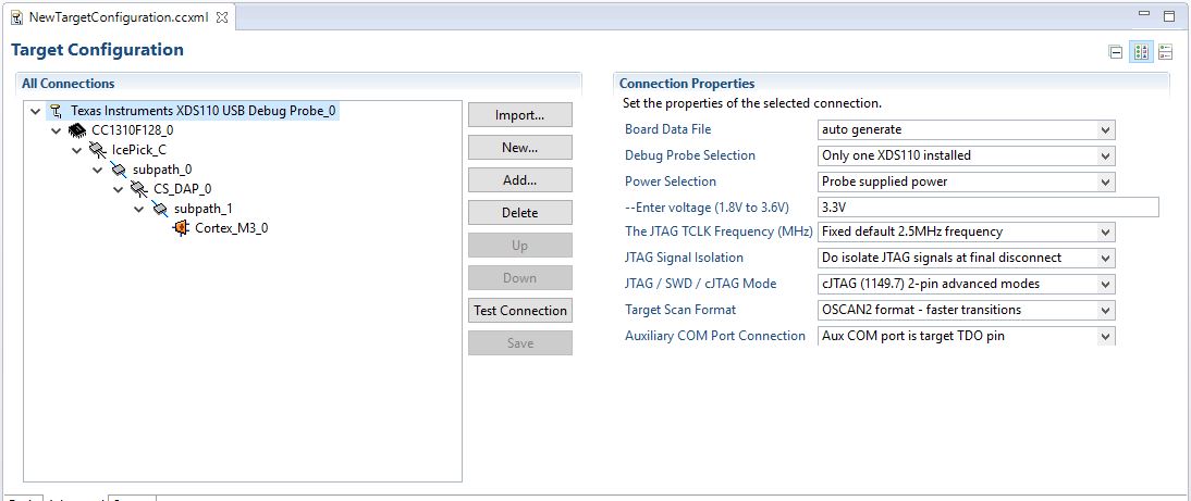

  • Hi Rafael,
    Tried by saving the configuration file and tested XDS110 debugger on CC1310 launchpad this time. Receiving below error on Test Connection:

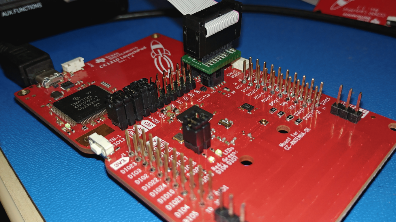

    Also note that the custom board is working perfectly fine. I have tested it by programming through Embedded XDS110 in CC1310 Launchpad. However, XDS110 debugger is not able to program either my custom board nor CC1310 in Launchpad.

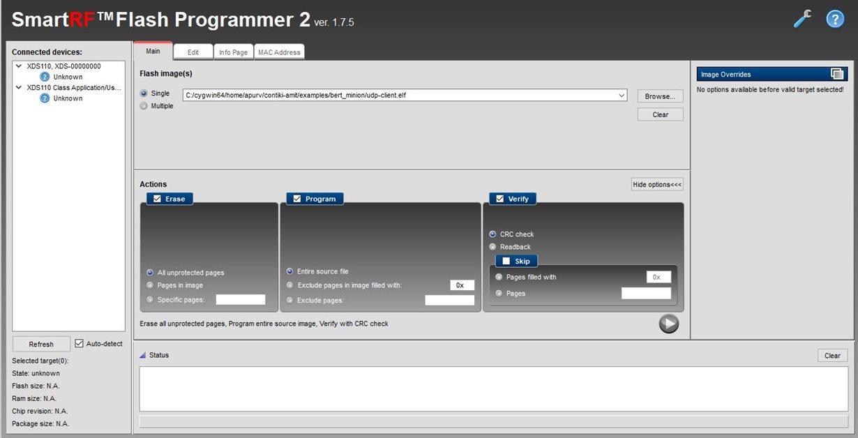

    Also, tried programming through Flash Programmer 2. XDS110 debugger is not detecting the target controller ( CC1310 ).
  • Apurva,
    Thanks for sending the photograph; the connection is reversed. In my working connection the XDS110 cable flows towards the emulator side of the launchpad, while yours is flowing towards the device side.
    Reversing this connection causes the same problem here.
    Rafael
  • Hi Rafael,
    I have been able to program now by choosing "Target supplied power" and providing external power to the board. However, problem still persists with "Probe supplied power option". I also checked VCC pin of the probe. I see 0V at that pin. Please find below error and snip of options chosen in configuration file.

  • Apurva,
    That is good to hear; it is a sign that the JTAG connections are correct.
