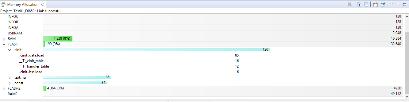

I get the following error in the console window.
Description Resource Path Location Type
<a href="processors.wiki.ti.com/.../10099"> program will not fit into available memory. placement with alignment fails for section ".cinit" size 0x2c1 . Available memory ranges: lnk_msp430f6659.cmd /DM10-10-18Project line 152 C/C++ Problem
/lnk_msp430f6659.cmd", line 152: error #10099-D: program will not fit into available memory. placement with alignment fails for section ".cinit" size 0x2c1 . Available memory ranges:
FLASH size: 0x7f80 unused: 0x0 max hole: 0x0
If I change the link command file from this;
   .cinit      : {} > FLASH             /* Initialization tables
to;
   .cinit      : {} > FLASH2            /* Initialization tables
it compiles, but I don't know if that is okay to do?  I want to be able to download new firmware from the built in USB BSL, so I dont want to step on any memory that is reserved for that?

  • Why .cinit is so huge?
    Did that came from grlib?
    Could you check and post .cinit memeory allocations using View -> Memory Allocation :
  • Hello Jerry,
    You could potentially move cinit to FLASH2 as you describe. Personally, I would do the directive to allow it to be placed into FLASH or FLASH2. That would look something like the following.
    .cinit       : {} > FLASH | FLASH2
    This tells the IDE to try to fit cinit in FLASH space and if it doesn't fit, to move to FLASH2 space.

    Notice it is correct to use > , but wrong to use >> .  That's subtle, but significant.  To understand the difference, please visit this article.  There is more detail specific to .cinit.  The section .cinit, because of how it is processed by the startup code, cannot be split.  It must be contiguous in memory.  If you try to split it, the linker issues a diagnostic.

  • Thanks guys. For some reason I can't copy the memory allocation, but the program is using 100% of  flash and about 35% of flash2. and 18% of Ram. Yes GRlib has a bunch of fonts and I have stored images. Does it matter to use flash or flash2?
