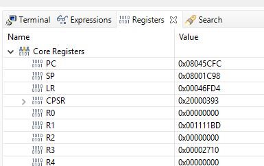

    The program loads but does not seem to run. If I set a break point at _coreInitRegisters_(); it stops there but I cannot step or run.
    It just stands at this position.

  • Lars von Wachenfeldt said:
    I use Spectrum Digital XDS560v2 PRO TRACE.
    If it is halting there, the MPU is probably still enabled from a previous program with the SRAM region not marked as executable.
    To avoid that, in the example project I placed a modified tms570lc43xx.gel file which issues a reset prior to loading the program.
    When the Debug Probe in the target configuration is changed, the GEL scripts reset to the default.
    In your target configuration, for the CortexR5 use the Browse button for the initialization script and select the tms570lc43xx.gel file which was contained in my example:
    [The above screen shot has a XDS110 Debug Probe since that it is what my hardware had]

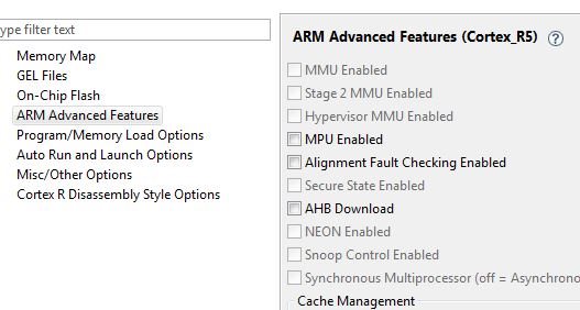

    I've loaded the program on a board where MCU 2 is not "locked". The program runs perfect. MCU 1 does not.
    One other thing you can try with the TMS570LC43x_flash_erase program on the locked MCU is:
    a. Under the debug project properties untick Auto Run and Launch Options -> Auto Run Options -> On a program load or reset. I.e. to stop at the entry point when loading a program.
    b. Start a debug session.
    c. If the program stops at _c_init00() check the "MPU Enable" option under ARM Advanced Features:
    d. If the MPU Enable is ticked, try unticking the option and then attempting to run the  program.

  • I went around that problem by selecting a fixed lib:
    But "MPU enabled/disabled" did not solve the problem unfortunately.
    Tried to erase flash again but get this message still:

    We now have a board and a running code which we can connect to via CCS using this:
    The PC points exactly where the code is halted but we cannot run/step/debug it. The PC just stands still.
    I try to erase via On-Chip Flash but no luck:

    I programmed your binary file to flash, and was able to execute the code. But after that, I am not able to erase the sectors in bank0, bank1, and bank 7. The code suspends at one location (pc=0x84f0) , there is no ESM error, and no abort (data and prefetch).
    0x000084F0  E307C965 movw r12, #0x7965
    After running this instruction, the R12 register should be 0x7965, but I read R12 which is 0x00000080 rather than 0x7965.
