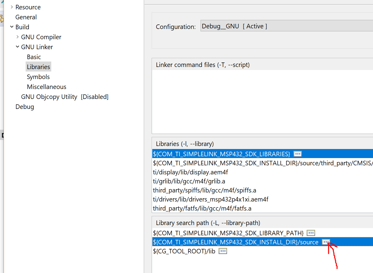

I also added the "Libraries" and "Library search path" from the Ti compiler properties, while I did this, I replaced some names pattern ccs -> gcc.

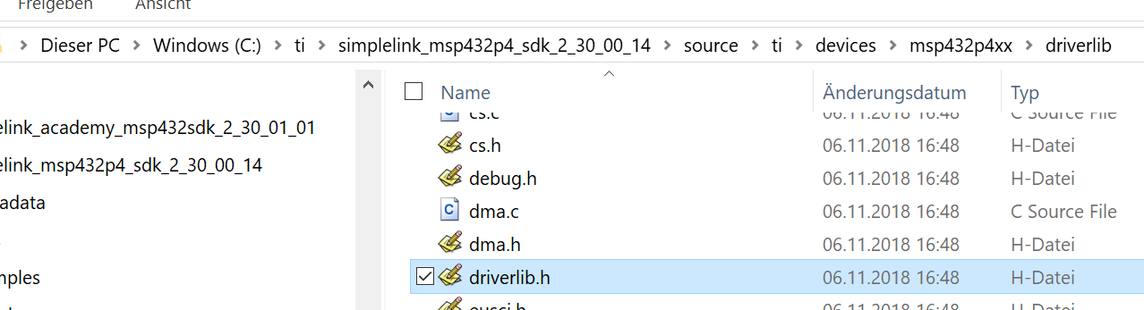

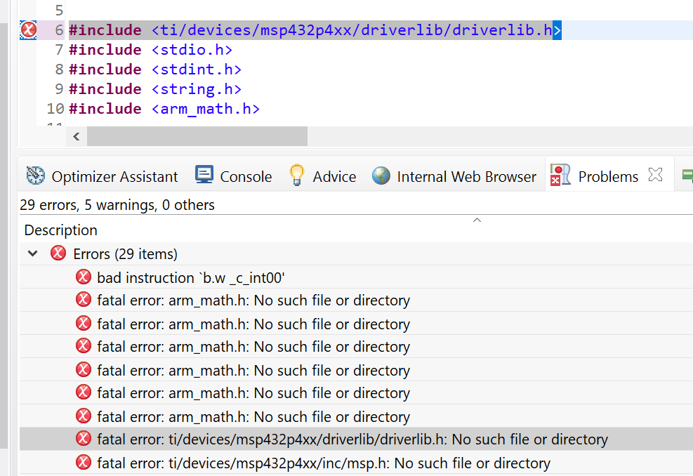

One of the error says that the driverlib.h don't exists. But as you can see it is an the setting I would say are correct.
Where is the problem, maybe the other errors are frome the same type.
    I don't know all the steps to convert this particular project from TI to GCC, but I can comment on the errors at hand.
    You are conflating the linker with the compiler include paths. The #include <> will use the options under the GNU Compiler and not GNU Linker paths.
    In this case, you must set a compiler include path that points to the directory C:\ti\simplelink_msp432p4_sdk_2_30_00_14\source to solve the first #include
    Likewise, you need to add a compiler include path to point to the arm_math.h and the msp.h files.
    After that you can start concentrating on further issues with the project.
    Hope this helps,
    Rafael

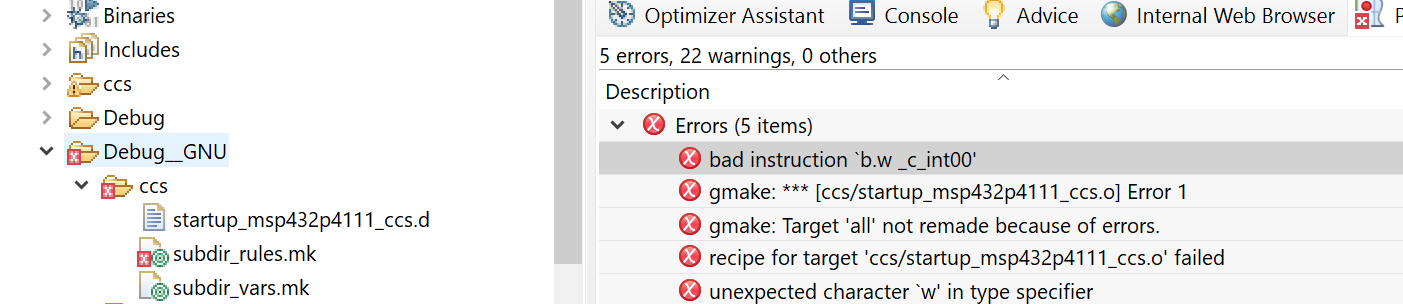

    Now I only have 5 mistakes left :-)
    I have no idea what it could be, a clean or rebuilt doesn't help.
    The last error seems to indicate the GCC does not like the "word" designator of the branch instruction of the file <startup_msp432p4111_ccs.c> The dead giveaway is the first error "bad instruction" and the filename is mentioned in messages 2 and 4.
    Looking at a few startup assembly examples for GCC I think you should remove the ".w" in the branch opcode. I think you will not have a problem given the device is already in thumb mode, but hopefully you will not have any additional problems.
    Rafael

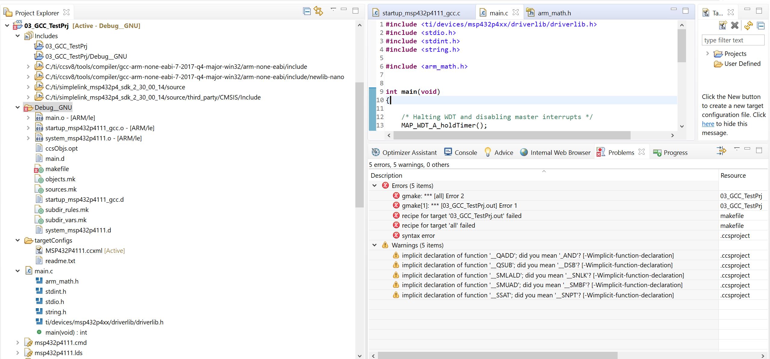

    And I fixed one missing include path. Now I have left 5 other errors, and warnings.
    If I comment the #include <arm_math.h> then this warnings are away, but the errors are there anyway.
    In the next picture I have some more information about the error from line 153 and 149:
    I hope with this descprition you can give me help once again...
    Thank you very much !
