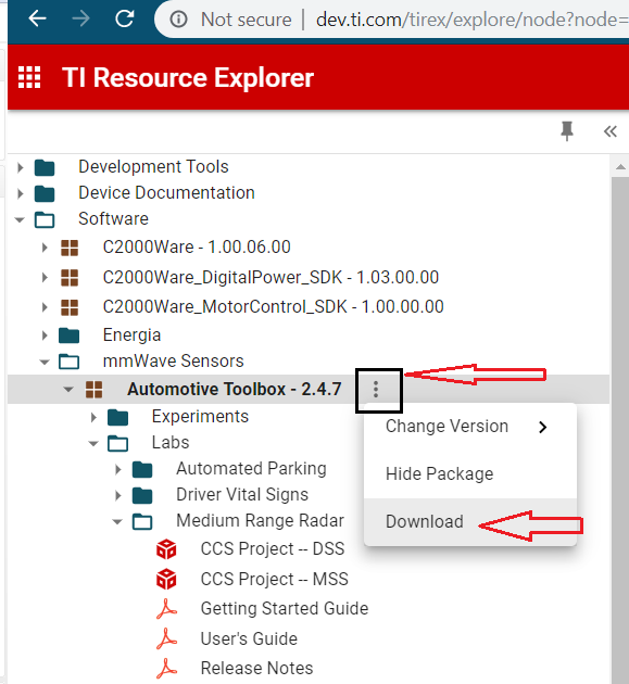

    The link I have provided above has the CCS project in it (src/mrr_dss.projectspec, mrr_mss.projectspec) which you need to import to CCS.
    First, you need to download Automotive Toolbox from TI-Rex.
    Unzip the downloaded file.
    Here are the steps to import to CCS
    - In CCS GUI:  select CCS Menu->Project->Import CCS project
    - Select search-directory
    - browse to MRR project path (C:\ti\mmwave_automotive_toolbox_2_4_7\labs\lab0007_medium_range_radar\src) and hit enter.
    - You should see MSS and DSS project of MRR listed in 'Discovered Projects'
    - Click finish, it will import to CCS workspace and will be listed under project explorer of CCS.
    Hope this will help you to work with CCS and MRR project.
    Now you have MRR CCS project ready, you can modify this project as per your need. To get the reference of HWA you can refer mmw demo (AWR1843) and drivers\hwa\test application. These are provided in makefile in SDK but with the above CCS project reference you can modify that CCS project (cloned version) to include the mmw demo or hwa-test application to CCS project.
