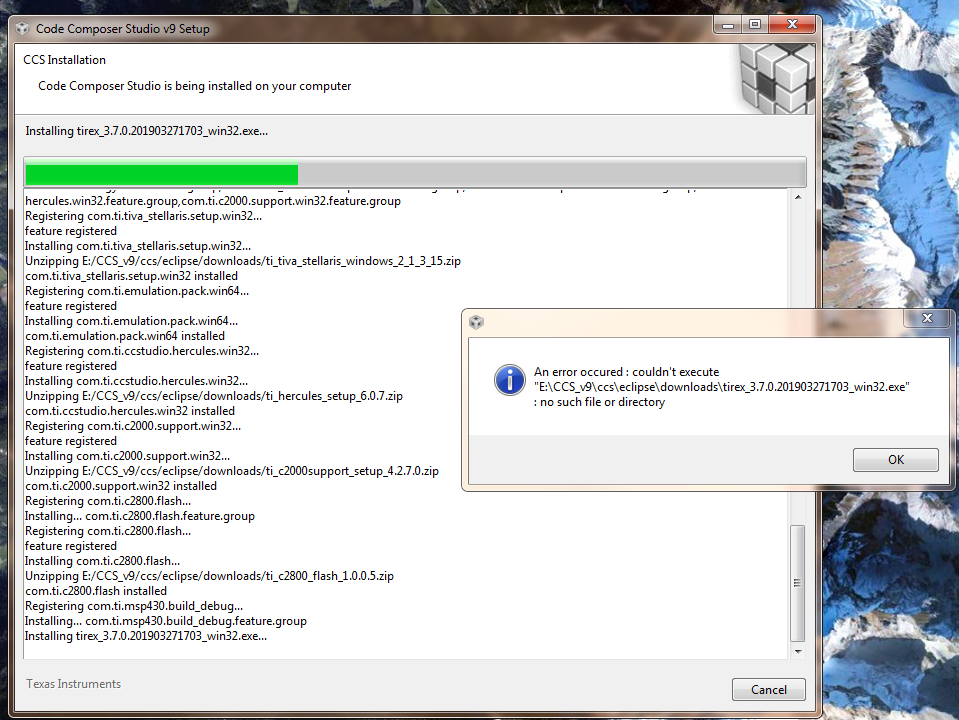

CCS/CCSTUDIO: consistent installation crash trying to install v9.01 on Win 7 x64. Had CCS v7 installed and used with no issues
Part Number: CCSTUDIO
During first part of installation, I get several (3-5) dialogs stating that a certain installation source file (some *.exe) can't be automatically deleted, and that user should delete said file before clicking continue. I can watch the \ccs901\ccs\eclipse\downloads directory and see the referenced file. It eventually is deleted within 10-15 seconds (some strange delay or access/permissions issue with filesystem?). By waiting, then clicking 'continue' the installation proceeds apparently without other issues. I eventually get the dialog below stating that a source isn't found and can't continue. I've cleaned-up the residual files in the typical directories (\appdata\*, and target installation folder) and retried several times without success - same eventual outcome. I have a zip file I'd like to attach of the installation logs and a couple extra files (all in *.zip) - How can I upload this?

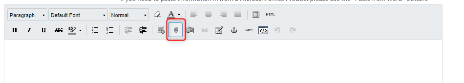

    In the advanced editor, use he "Attach" button to select your zip file.

  • Hi Kevin,
    It looks like something is killing off threads while the installer's running. There's definitely a timing issue because you shouldn't get that message about not being able to delete files unless you actually have some processes running.

  • Hi Ki - finally got to try this. I disabled Windows Defender and pulled ethernet from machine and ran 9.01 x64 install and got the same thing (periodic "please delete xxxxx file since the installer can't"-type messages, and an eventual installer error (attached)). The installer gets far enough that there is a valid uninstall entry registered with Windows. So I uninstalled it and tried it again. This time, for installation path, I attempted to select a 'normal' installation path (C:\program files) and interestingly, there is a pop-up warning that the program updater may not be able to update files in the future. This seems like a red flag.
    The inability for the installer to delete temporary files sounds like a permissions issue, and the fact that the CCS updater recognizes that it won't have the correct permissions to update files at a later date in the 'normal' windows application-installation folders (c:\program files; c:\program files (x86)) sounds again like there is a fundamental permissions issue. Does the CCS installer run as a 'Trusted Installer'? I only know a bit about this, but I checked folder structure security (permissions) and I didn't see any obvious problems.
    Lastly, I tried installing into another partition on another drive - sometimes there are issues with permissions unique to the root of the partition that the OS is installed in (typically c:\) and the CCS installer want to default to a subdirectory (c:\ti\xxxxxx). I had the same issue with a totaly different location - mostly installed, but had the same "please delete files" and eventual install failure, but at least there wasn't a warning about the updater not being able to update files in this alternate location.
  • Hi Ken,
    Thanks for the latest details. Our installer expert is still pretty sure that there is some kind of additional run-time file scanning happening on your system that is preventing the executables from being run. Could there be any other security software... anything that does real-time file scanning... something that is still running on your system (besides Windows Defender)?
