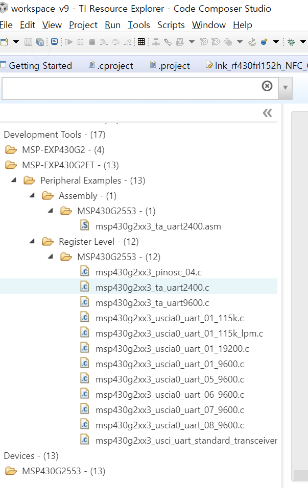

I want to connect MSP-EXP430G2ET and TRF7970ABP as a reader and read the ADC0 value of RF430FRL152H-Patch.
Because E2E community recommended a method called UART, I want to use it. Which of these codes do I need to read?
++Modified.
I downloaded anything, then imported.
And I ran it like a picture, and while it was being debugged, there was no output.
Is this normal?
I want the printed value. What should I do?
  • + Additional questions
    What function must be entered to output the ADC0 value of RF430FRL152H?!
    And I'd like to print out the results of the ADC0 in the form that I made.
    Is that possible?

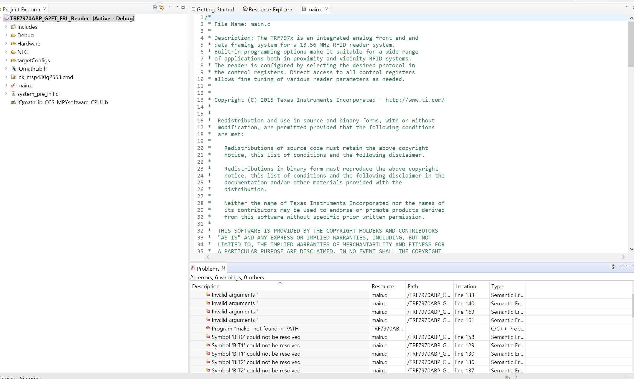

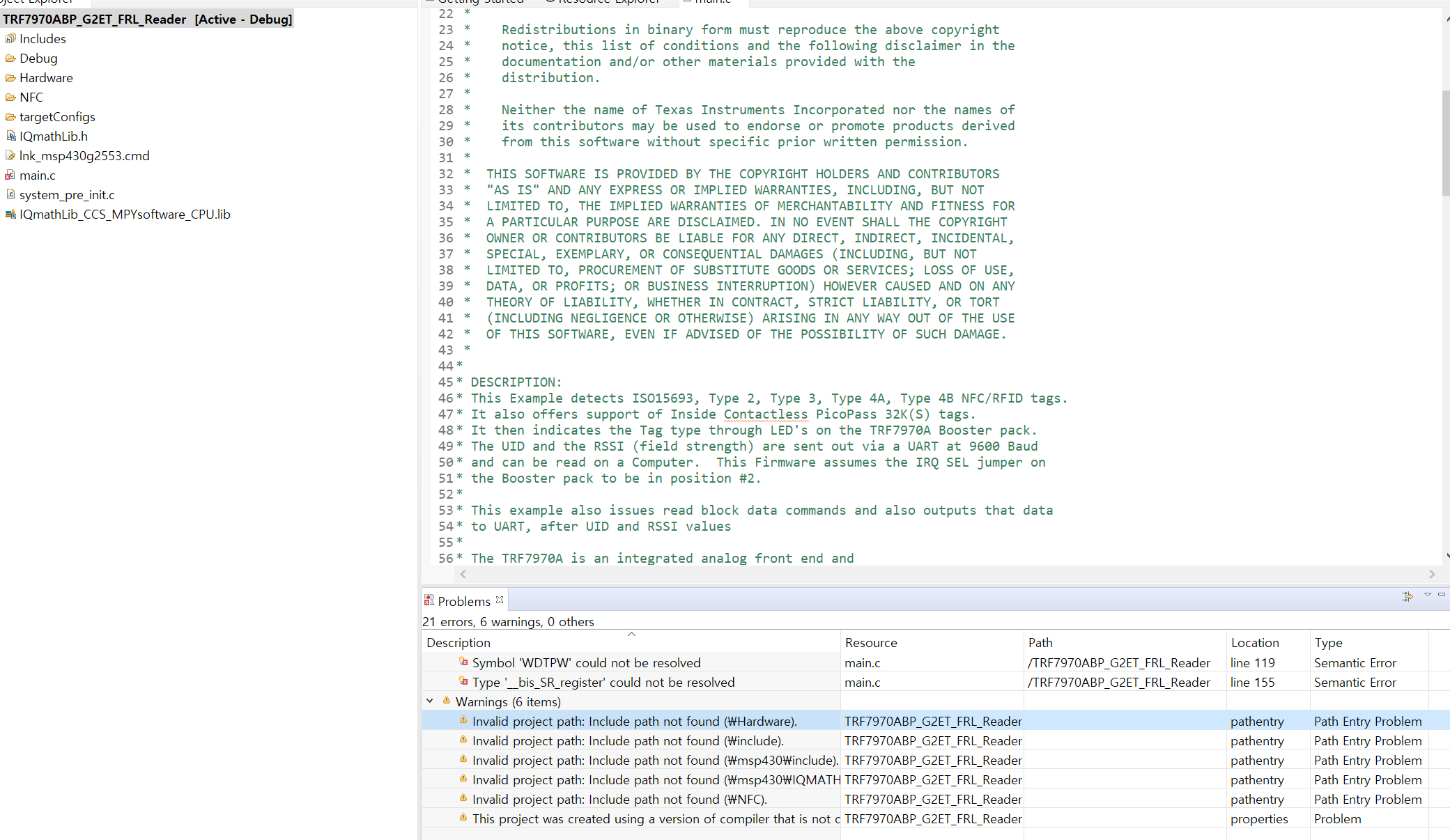

    However, when I attempt to open and run a project, the following error occurs:
    What's the problem?
    (The folder is located on the desktop.)
  • Description Resource Path Location Type
    This project was created using a version of compiler that is not currently installed - 16.9.7.LTS [MSP430]. Another version of the compiler will be used during build - 18.12.1.LTS. See 'Help > Install New Software' and select 'Code Generation Tools Updates' to check if this compiler is available through a CCS update. Visit <a href="liveaction:OpenAppCenter">CCS App Center</a> to get the latest compiler support. Or <a href="software-dl.ti.com/.../a> and install the compiler, then register it with CCS through 'Preferences > CCS > Build > Compilers'. TRF7970ABP_G2ET_FRL_Reader properties Problem
    This error is particularly suspicious.
