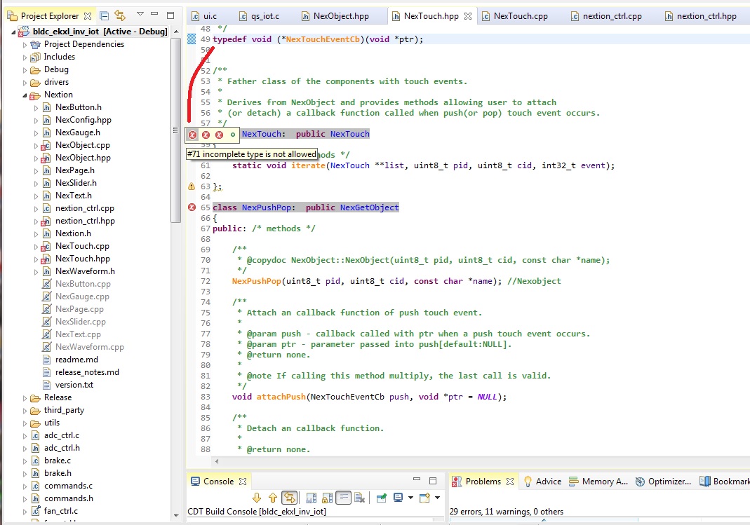

CCS 7.3 upgrade to 8.3 fixes some Symbol resolve issues and causes other code analysis errors for  (uartstdlib.c, uartstdio.c)  that have never been a past problem even in CCS9.1.
The class fix was supposed to make public/class identifiers & names  be resolved. Well symbol names resolve now but identifier class not defined causes other errors. Parsing then hick-ups inside the class identifier *.h file. It may be why the uartstd~.c errors are occurring further down the include list. What is missing from the include list for CLASS identifier to be defined? It seems like the name symbol CLASS causes the parser to think it requires ( ; ) after it.
#20 identifier "class" is undefined
class  NexObject
public: /* methods */
The code analysis via IDE defaults assumes uartstdlib.c has new issues, never in several versions of CCS has that occurred.
#110 expression preceding parentheses of apparent call must have (pointer-to-) function type

    The bigger bug is the class errors even after combining NexObject.cpp code into the NexObject.h  and Touch.cpp into NexTouch.h. excluded all the other *.cpp not of interest but the headers remained. You can add the folder to any project to see these class errors. The odder ones come from Tivaware calls top of NexInit() as the parser gets lost.
    Edit: Header files extensions changed to C++ reduced to 18 compiler errors
    /cfs-file/__key/communityserver-discussions-components-files/81/4705.NexControls.zip
  • Hi Ki,
    After renaming *.h to *.hpp, then made a unique & separate class for the second public inheritance (below) seems to push the compiler C++ parse pointer upward. The (typedef) incomplete error seems to lead to all the other C++ parsing errors there after. The C file (nextion_ctrl.c) was calling a C++ public class function. So the C compiler had no reference from the index leading IDE to find the C++ public class being called. I also renamed public NexObject class NexGetObject believing some kind of class inheritance issue was causing C++ 59 parsing errors.
    Do you know what is wrong with the typedef leading to C++ compiler parsing errors below it?
  • Also tested different General C++ Formatter formats (GNU,BSD,K&E - etc..), same issue. Perhaps class identifier not defined errors since the CCS IDE fails to differentiate between C & C++ calls? That was apparent as Tivaware calls (nextion_ctrl.c\NexInit()) were not being parsed correctly. After renaming (nextion_ctrl.cpp) Tivaware calls were parsed correctly but still had issues with (class) identifier being resolved in both CCS 8.3 and 9.1
    The base Tivaware project builds successfully with no issues without the Nextion folder in the build. Perhaps the packaged C++ Formatters are not proper for the Public Class layout or some other IDE issue exists?

    It don't matter all the way up to 5.2.8 -> 18.12.3 LTS all do the same even with C++ code analysis disabled in preferences. Mention to ArtiG in other thread it seems we can not mix C tool chain & C++ in the same source file or (class) even for *.cpp source file type.
    As C directives may be compiled first the later C++ directives are not understood in the (*.h/hpp or *.c/cpp) source files, it don't matter what the extension is made.
    The question seems to be why in CCS can not C and C++ directives coexist in the same source file?

    Mentioned in other CCS9.1 post the compilers parser gets lost when C++ & tool chain commands coexist in the same source file. I simply gave up on trying to comingle source types, e.g. Tivaware library calls mingled with C++ syntax that Arduino IDE does not seem to have a problem handling.
    The 3rd party GIT library was buggy C++ syntax (class public/private) comingled with Arduino tool chain library calls via *.cpp file extension. It really didn't matter in the end having to re-write the serial I/O for TM4C1294 use without class types. Currently long/short integer conversions to 8 bit ASCII is more problematic.
