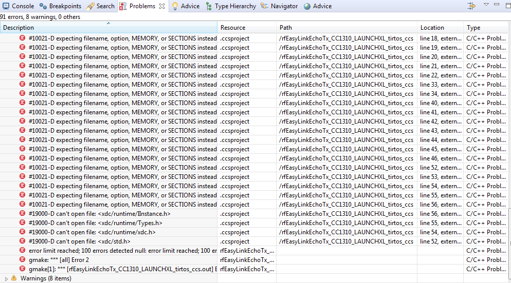

  • Hi Ki,
    I have added the path as you mentioned. Now I'm getting error #10008 and warning #10007.
  • i'm not sure what those number refer to. Please provide the full error descriptions in the console.
  • Hi Ki,
    please find the attached screenshot of the errors I'm getting after solving the previous errors as mentioned in comments above.
  • Please provide the build console output. That is more helpful for us to analyze.

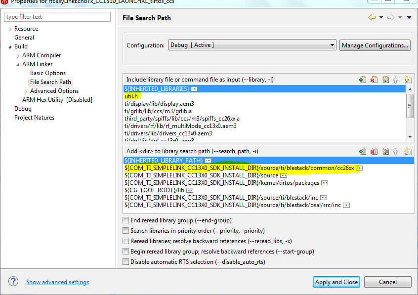

  • Hi Ki,
    Thanks for the response.
    "You need to to include the object file(s) that define ExtFlash_open and Util_constructClock".  How can I include the object files? and where?
    For your information:
    1) I'm already including the path "#include <ti/blestack/common/cc26xx/util.h>"
    2) As you mentioned I already added the path of the files => Under Project Properties -> Build ->Linker ->File Search Path
    This would provide the function declaration. But not the definition.
    What is the difference?
    http://c-faq.com/decl/decldef.html
    Did you just add the path to the --search_path option? That is not enough. You need to specify the object/library file that the functions in question are defined in.

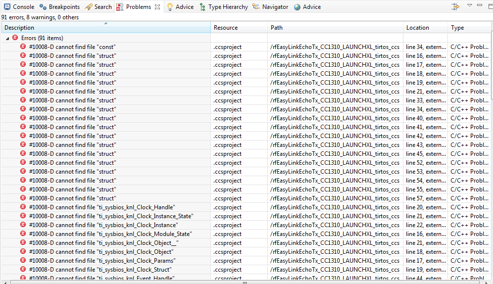

  • Hi Ki,
    After adding the the path to the --search_path option, and then specify the object/library file , i got the following error =>
    **** Build of configuration Debug for project rfEasyLinkEchoTx_CC1310_LAUNCHXL_tirtos_ccs ****

    Please find below my search path adding, and library files:  => highlighted in yellow
  • util.h is a header file. Not an object file.
    https://stackoverflow.com/questions/7718299/whats-an-object-file-in-c
    You do NOT specify header files in the --library options field. You specify object files and library files.
    Where are ExtFlash_open and Util_constructClock defined? If it is in a C source file that you can add to your project, then add it to you project. If it in a library file that you can reference, then specify the library file in the --library options field.
  • Thanks for clarification. I was thinking header as library file.
    Util_constructClock is defined in a C source file. But it has dependency with other headerfiles like hal_types , hal_defs, bcomdef.h etc. So if I add it to my project, again I have to give path search path?
  • You will need to make sure you have the header file include search paths to those dependent header files set up properly. Those can be set under "Compiler -> Include Options""
  • Hello Ki,
    Thanks, it worked after adding util to the project and adding the path of dependent header files.
