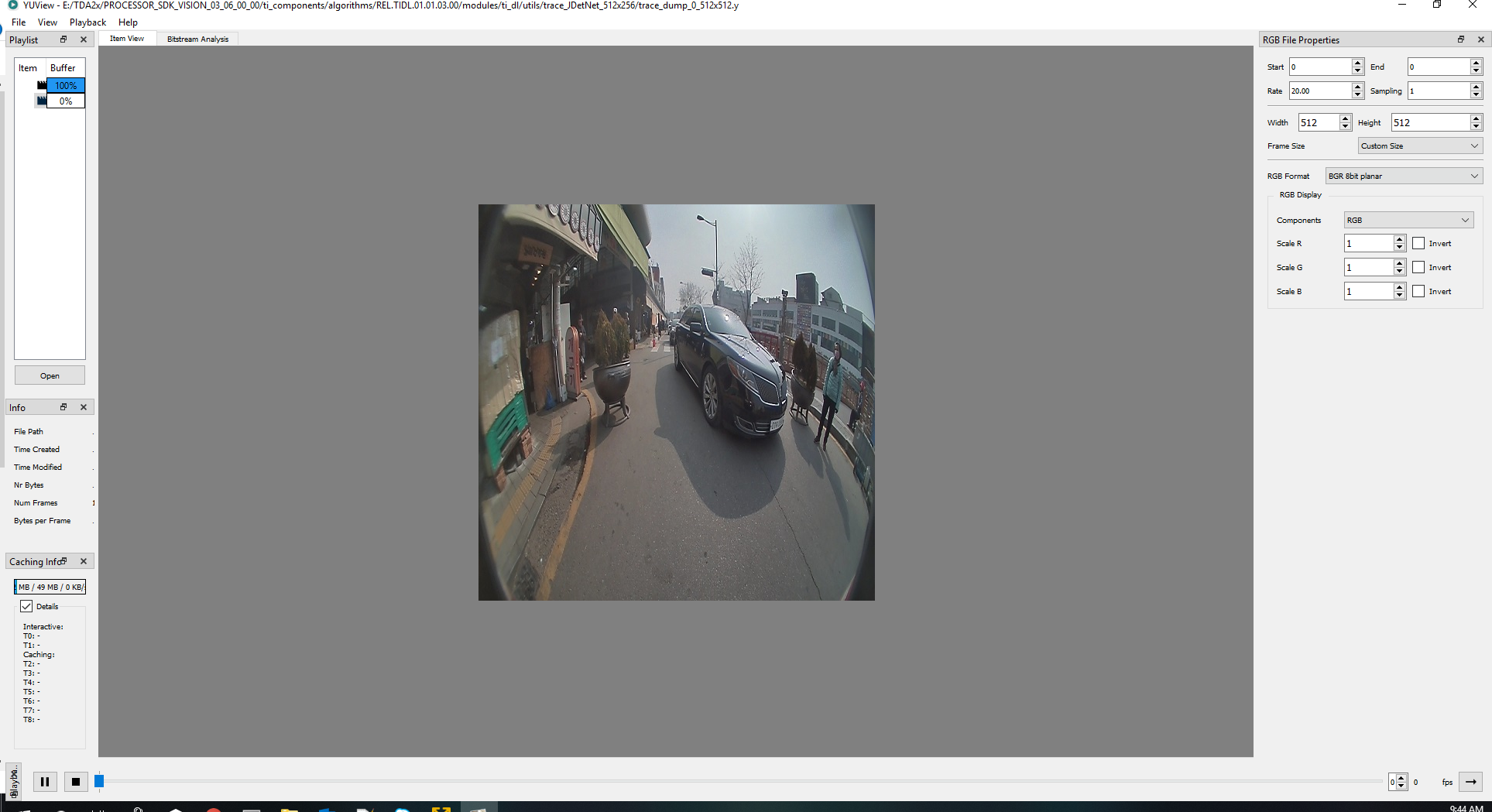

Observation: For TDA2x:
Resolution is 512x512x3
Layer dump: 0(Data layer)trace_dump_0_512x512.zip
Size: 512x512x3 = 786432 bytes
Layer 0 visualized through YUView is below:

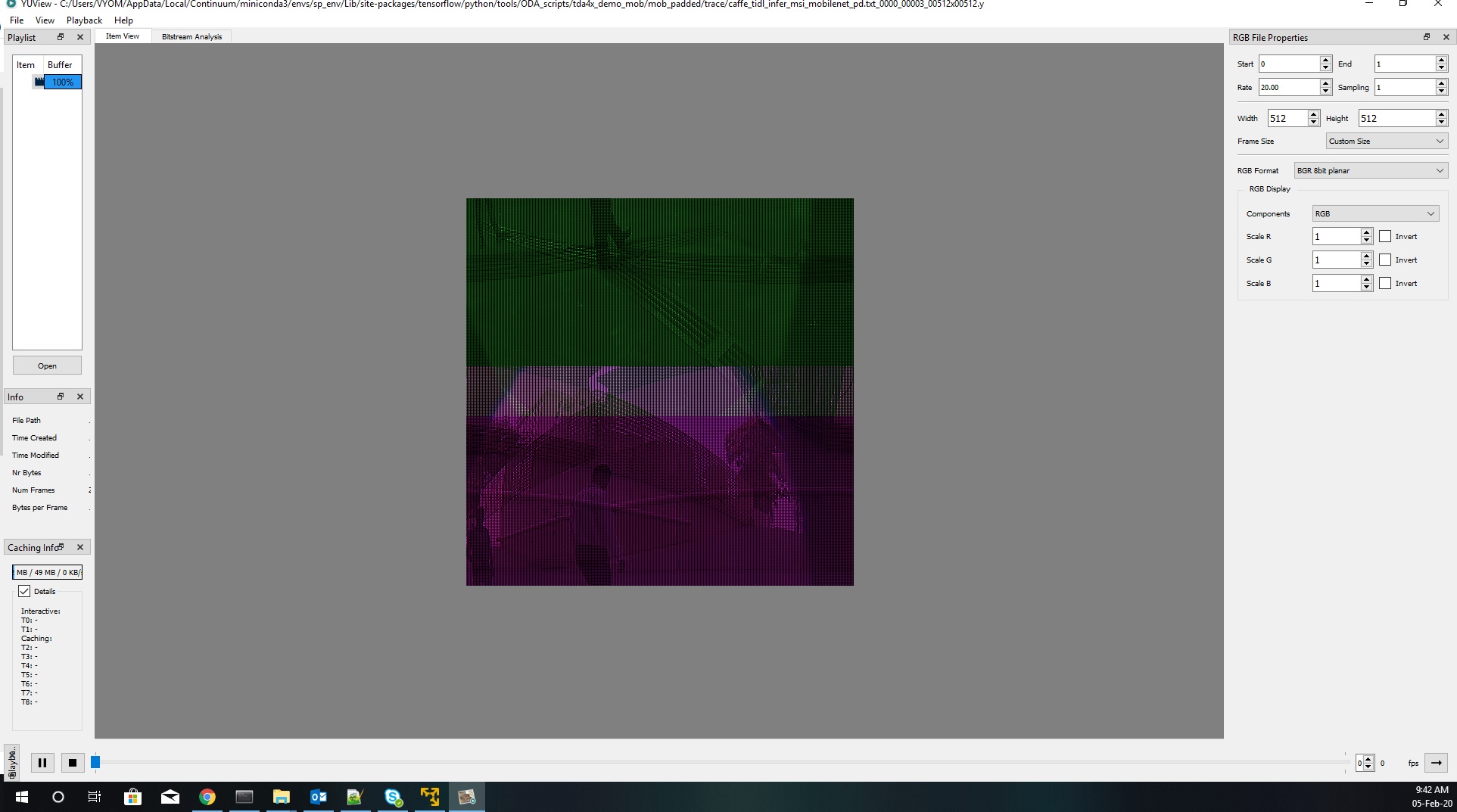

Observation: For TDA4x:
Layer dump: 0(Data layer)caffe_tidl_infer_msi_mobilenet_pd.txt_0000_00003_00512x00512.zip
Size: 512x512x3 (x2)extra is observed = 1572864 bytes
For TDA4x:
Why the layer dumps has the double size of the input(512x512x3)?

  • Vyom Mishra,
    I am attaching an image. Can you verify that this is your intended output? With the black pads in the top and bottom rows?
    This is a 512 x 512 image with size = 786432 bytes and it is derived from the file that you attached.
    In your file, each feature is 16 bits wide, and I had to run the following code to get the correct image
    for(i = 0; i < 512 * 512; i++) {
    new_buffer[i] = ((uint16_t*)buffer)[i];
    new_buffer[512 * 512 + i] = ((uint16_t *)buffer)[512 * 512 + i];
    new_buffer[512 * 512 * 2 + i] = ((uint16_t *)buffer)[512 * 512 * 2 + i];
    https://e2e.ti.com/cfs-file/__key/communityserver-discussions-components-files/81/caffe_5F00_tidl_5F00_infer_5F00_msi_5F00_mobilenet_5F00_pd.txt_5F00_0000_5F00_00003_5F00_00512x00512_2D00_modified.y
    - Subhajit
  • Dear Sir,
    Now the image visualized is correct with black pads in the top and bottom rows.
