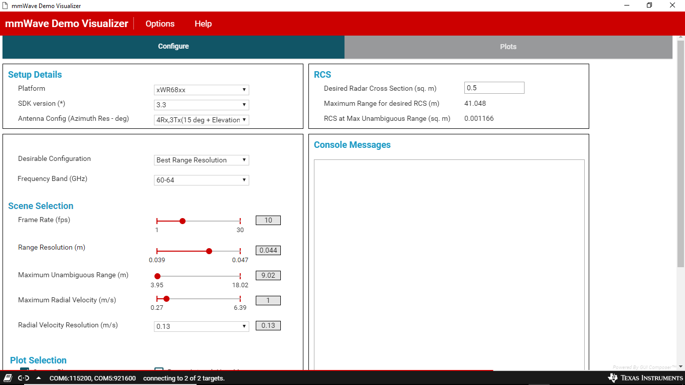

  • Hi Priyanka,
    1. You can find the OOB binary in the SDK at: C:\ti\mmwave_sdk_03_03_00_03\packages\ti\demo\xwr68xx\mmw\xwr68xx_mmw_demo.bin
    2. Flash device with this binary
    3. Go to the online visualizer here: https://dev.ti.com/gallery/view/mmwave/mmWave_Demo_Visualizer/ver/3.3.0/
    4. Use the options menu to connect to the device
    5. Select IWR6843
    6. Select 4 Rx 3 Tx
    7. Load the default configuration
    8. Console on the right will display the sent commands and the "Done" acks from the device
    More detailed instructions are here in the quickstart section: http://dev.ti.com/tirex/explore/node?node=AM1kRI3l5vvDUDVn-RHrxQ__VLyFKFf__LATEST
    Justin
  • Hi Justin,
    As you suggested the above steps has done with mmWave Demo Visualizer 3.3.0, there UART PORT is connected but DATA PORT was waiting to connect (i.e. in connecting state). I attached the image also for your reference..
    Once both(DATA & UART) the ports got connected then only it show the console with its acknowledgement..
    I got stucked with this part only from starting...
    But I have Loaded the configuration file and given send config also ..
    Please help me to resolve this issue..

    When you run the OOB, it will only show connected to 2 of 2 after sending the configuration.
    when you clicked on "send config to mmwave device" did it fail to show point clouds?
    Also can you share a picture of your setup?

    2. Now I coldnt able to run the same cfg file(profile_iwr6843_ods_3d) with demo visualizer, giving errors while loading the cfg it's showing invalid no.of arguments in "compRangeBiasAndRxChanPhase  0.0 1 0 1 0 1 0 1 0 1 0 1 0 1 0 1 0 1 0 1 0 1 0 1 0" ..
    And when I give sendcfg it shows that " xwr68xx is not matching to xwr68xx_AOP"
    3. Also GUI is not providing the target points and it doesn't showing any plots..
