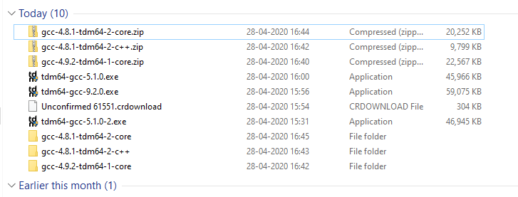

  • i changed TDM GCC with an older version. it's OK now. Tks.
  • Can you let me know, how did you do that? Where did you get it?

  • Hi Stefan,
    I also facing the same problem for reference
    But problem was not resolved with older version also.
    I downloaded older version tdm64-gcc-5.1.0(not tdm64-gcc-5.1.0-2).
    Kindly share the which version u downloaded.If possible provide path.
    I checked with the below attached TDM files but still problem is coming.
    Rakesh D
