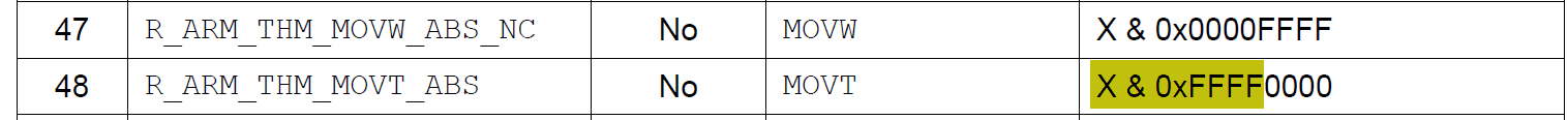

However, the expected result for the MOVT is:
MOVT.W          R3, #2048

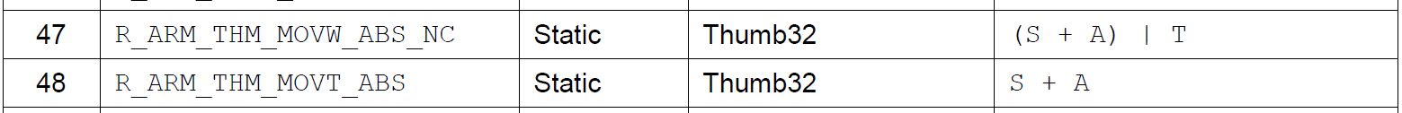

The issue I think is in how the TI Linker implements the relocation R_ARM_THM_MOVT_ABS.
S + A means:
  • S (when used on its own) is the address of the symbol.
  • A is the addend for the relocation.

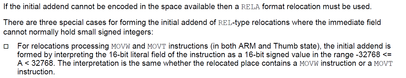

The addend is the value that is "already" in the imm16 filed of the MOVT instruction (24).
This would mean that the Linker has to calculate the following: 0x08003F70 + 24 = 0x08003F88 and take the upper 16 bits and put it in the imm16 field of the MOVT instruction ( ( ( 0x08003F70 + 24 ) & 0xFFFF0000 ) >> 16 or ( ( S + A ) & 0xFFFF0000 ) >> 16 ).
However it seems that it has calculated: ( ( 0x08003F70 & 0xFFFF0000 ) >> 16 ) + 24 or ( ( S & 0xFFFF0000 ) >> 16 ) + A

    It seems that GNU and TI take to different approaches to represent the movt label + x instruction.

    It is visible that the instruction on the left (using the GNU object file) uses the wrong offset (4 instead of 0).
