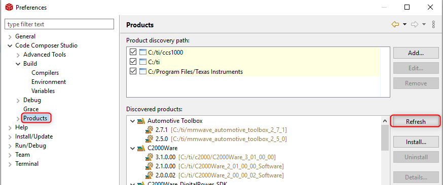

I installed simplelink_cc13x2_26x2_sdk_4_10_00_78 on c:\ti path, while the CCS 10 resource explore offline could not detect this SDK, any guider to solve it?

In the CCS Preferences dialog (Windows -> Preferences), can you go to the product discovery section and press the 'Refresh' button? Install any newly detected items and restart CCS. This should help resolve the issue. Note that while the SDK itself may not appear in the list of newly detected items, but CCS will discover it.
