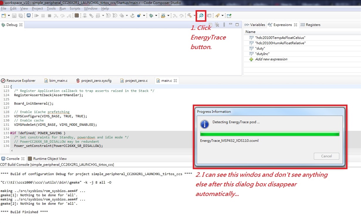

CCS/CCSTUDIO: EnergyTrace stand-alone-mode doesn't launch EnergyTrace window in my CCS Version: 10.0.0.00010
Part Number: CCSTUDIO
Other Parts Discussed in Thread: ENERGYTRACE
When I test EnergyTrace stand-alone-mode in my CCS  Version: 10.0.0.00010, CCS doesn't launch EnergyTrace window after I click the EnergyTrace Ico on Tool bar. How can I know what is going wrong in my CCS?

  • I already try to change the default probe for EnergyTrace - but it doesn't fix my problem. Using "-clean" cannot fix the issue. I also try to delete everything under directory %HOMEPATH%\.TI-trace but the problem is still there. Do you have other suggestions?

  • I tried delete the CCS temporary files at %APPDATA%\Texas Instruments\CCS and reinstall CCS10. Both doesn't work.... Too bad...Is there still anything I can do to fix this? Or can you tell me when I can get the CCS log for you to clarify this issue?
  • After I reinstall CCS 10 and update everything, it finally comes back. Cheers!
