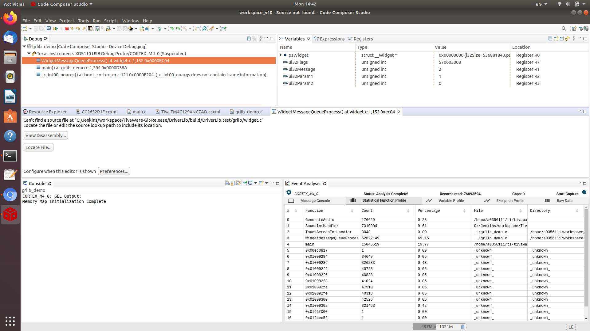

    Thanks for the detailed report. One of the teams looked at the logs for both OSes but unfortunately did not find a "silver bullet". On the Windows version it seems to be originated in a component responsible for the advanced trace (cTools), but no further debug information is available. For Linux, the dump collapsed at an unallocated address but no log as to where this bad address came from.
    I naturally tried to reproduce the issue here - I am using my DK-TM4C129X and Ubuntu 18.04.4 on both CCSv10.0.0.00010 and a beta release of CCSv10.1.0. All this is running on a native install of Ubuntu 18.04.4 on a Intel® Core™ i7-2620M CPU with 8GB RAM.
    Unfortunately I couldn't get any fault on the tools, and I captured several runs with millions of records with no problem.
    Since you mentioned this is intermittent, I will keep trying to reproduce this. I am using the grlib_demo code (quite complex and full of different threads, but no TI-RTOS) on my system here. Please let me know if there is something else that you think may trigger the problem.

  • Chester,
    Thanks for sending the additional information - I was missing the fact you were start and stopping the data capture with the Trace view opened.
    I can reproduce this here and noticed an interesting detail: the Trace data analysis seems to complete (shows the message Analysis complete!) only on the first time for me. A bug report will be filed.
    I apologize for the inconvenience,
    Rafael
