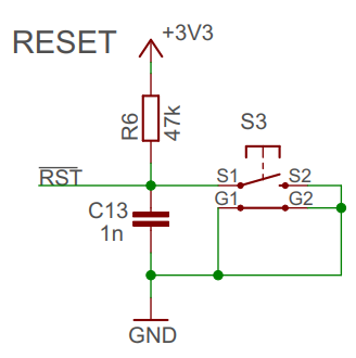

  • Hi Tajpeer
    How many MSP432P411 on your customer board be tested? All failed?
    I saw you have add a TPDxF003 on JTAG pins for ESD protection. Why do you pull up the TMS and TCK pin with 10k resistor?
    Could you have a try to remove the pull up(R60 and R63) and pull down resistors(R64) on JTAG pins?
  • Hi Gary
    We have tested two custom boards having MSP432P411VIPZ. The issue persists in both the boards.
    As per your suggestion we have removed the resistors R60, R63 and R64 and flashed. But still the problem persists.
  • Hi Tajpeer
    What if bypass the TPDxF003?
    By the way, please follow the reset circuit as below
