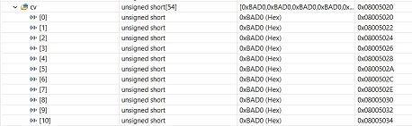

I'm using CCS10, MS570ls0432 and TMDSEMU110-U debugger. The debugger mode is JTAG. The debugger firmware has been automatically updated to 3.0 when I start debugger process.
I add a global variable in the expression window, when the program is running the global variable hasn't been updated periodically even with the continuous refresh pressed. The variable only can be updated if I press the pause button or program hit breakpoints. When I use the TMS570ls0432 demo board with onboard debugger, the debugger will continuously refresh the global variable in the expression window when the program is running. Please give some suggestion. Thanks.

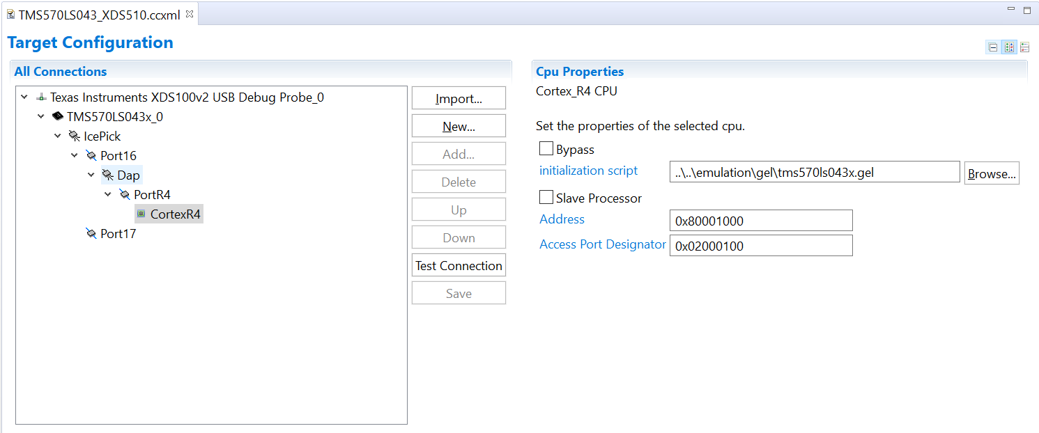

  • Hi Chester,
    I attached the screenshots and debugger connection log.The first screenshot shows no updates when program is running and the contentiously refresh pressed. The second one shows the data has been updated if I press the pause button or program hits breakpoints. Thanks.
    What I have noticed from your first screenshot, and the debug server log, is that when the target is running the XDS110 returns the hex value "0xBAD0" for the target memory. From a quick search I think that the value "0xBAD0" means the memory read failed for some reason n, but at the moment not sure at what point the error occurred (e.g. in the CCS Debug Server or XDS110 probe).

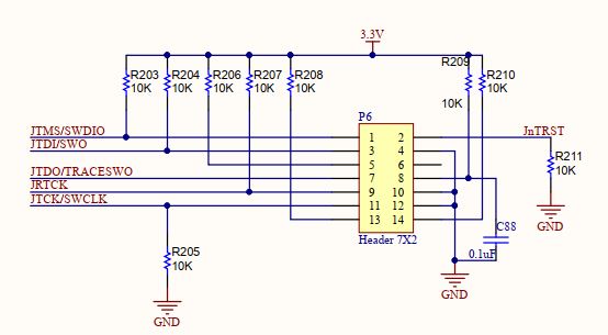

  • Hi Chester,
    Thanks for your support. I don't enable any MPU function in program. We use FreeRTOS which codes generated by Halcogen.
    Here is our debugger interface. Could you please review it. Thanks!
    My only comment is the 10K R206 between 3.3V and P6 pin 5 which is VTRef for the emulator looks high. The recommendation from Emulation and Trace Headers Technical Reference Manual is to use a 100 ohm current-limiting resistor between the target supply and VTRef. However, given that the only issue with the XDS110 is continuous refresh not working the value of R206 probably isn't the cause.
    You could also try reducing the JTAG TCLK Frequency (MHz) of the XDS110, see http://software-dl.ti.com/ccs/esd/documents/xdsdebugprobes/emu_xds110.html#debug-and-trace-usage-modes, in case has an effect.

  • Judy,
    Please apologize for "disappearing". I agree the issue seems functional, but it may be tied to the circuit itself that may be limiting or corrupting the data transfers - the XDS100v2 and the XDS110 have different JTAG line drivers and therefore dependent on variants on the circuit itself.
    Looking at the schematics, in addition to Chester's suggestion I would remove the resistors R203, R204, R206, R207 - they will degrade the JTAG signals. The information for this is shown not only on the LAUNCHXL-TMS57004 schematics but also on our reference design guidelines shown at the section Target Connection Design of the XDS Target Connection Guide at:
    https://software-dl.ti.com/ccs/esd/documents/xdsdebugprobes/emu_xds_target_connection_guide.html
    As a side note, I would also reduce R208 and R210 to 4.7kΩ, but that is not really related to the issue at hand.

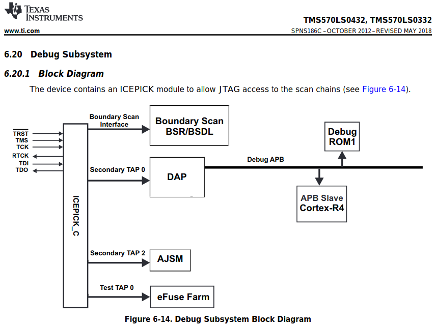

    I remembered the previous thread Can't get CCS 6.1 "Continuous Refresh" for Memory or Expression views to work for Hercules devices where for a RM42 device continuous refresh didn't work when the target was running due to:
    One note about the difference between RM42 and RM46: RM42 does not have the functional path wired to allow access to the memory map via DAP.
    I think the TMS570LS04x devices may have the same limitation as the RM42 devices.
    The only way I could get continuous refresh to display variables while the TMS570LS0432 was running under the project properties Debug -> Auto Run and Launch Options -> Realtime Options was to enable the "Halt the target before any debugger access (will impact servicing of interrupts)" option, but that impacts realtime performance as the CCS debugger has to keep pausing and then resuming the target.

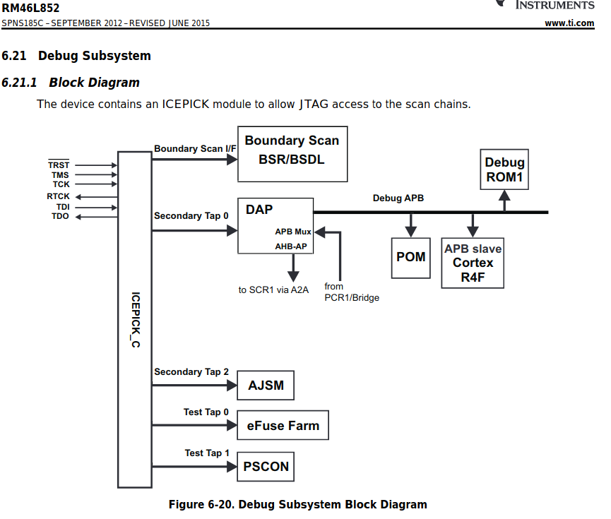

  • desouza said:
    Unfortunately the small design choices implemented inside these devices are sometimes hard to track, especially because these devices clearly show a DAP on their JTAG routing (which usually allows memory access without CPU intervention).
    I think the difference is if the AHB-AP interface on the DAP is connected on the device.
    E.g. the datasheet for TMS570LS0432 device which doesn't allow memory access while the target is running doesn't show the AHB-AP interface on the DAP:
    Whereas the datasheet for the RM46L852 which does allow memory access while the target is running does show the AHB-AP interface on the DAP:
  • Chester,
    Nicely spotted; you are probably right given the AHB will allow high speed access through the debug port (reference), but it is still almost a "footnote" on a large document.
    I parsed the TRM and found out the RM46x has references to the AHB and its interconnection with the VBUSM (figure 2-1 and further down the text), while the TMS570LS04x/03x is much simpler with no AHB Access Port. Regardless, on both I miss a full chapter about the Debug Subsystem (something I could probably find in a Keystone II device, for example).
