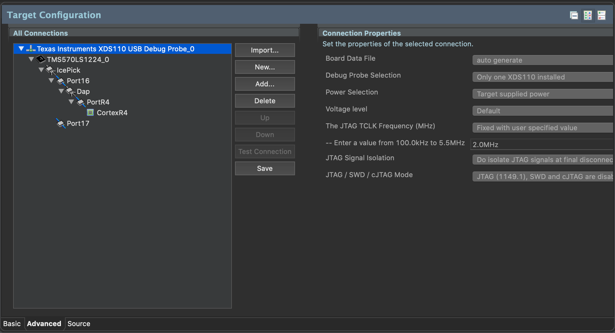

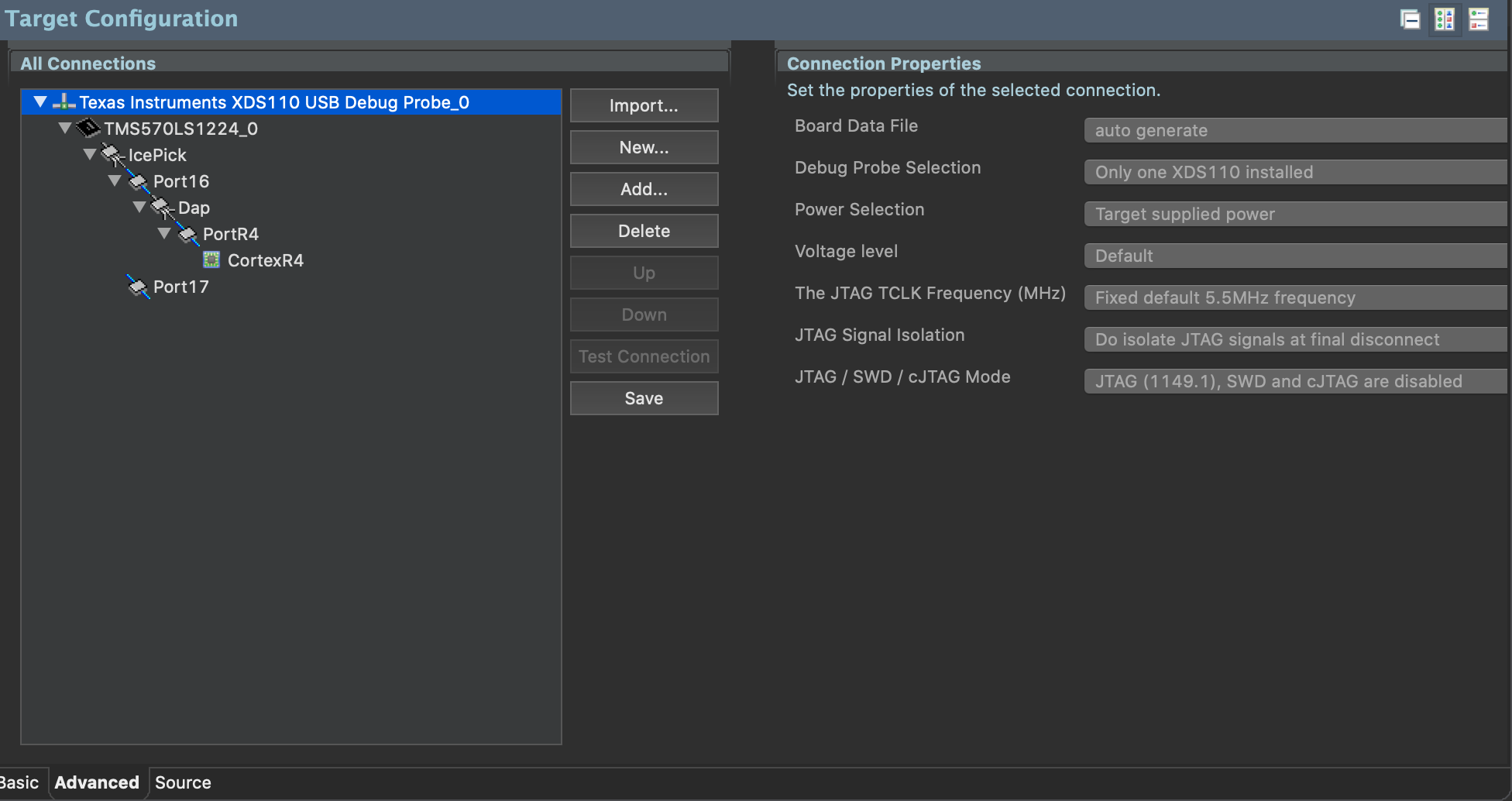

I`ve been working on my project from June to mid October without any problems.
Today I resumed working on the same project and on the first Debug attempt, CCS 10.0.0 asked me to update the firmware of the XDS110 probe :
IcePick: Warning: A firmware update is required for the XDS110 probe. The current firmware is version 3.0.0.13. The probe must be upgraded to firmware version 3.0.0.14 to be compatible with this software. Click the "Update" button to update the firmware. DO NOT UNPLUG THE DEBUG PROBE DURING THE UPDATE. (Emulation package 9.2.1.00042)
Since the firmware update, I cannot use the CCS Debugger, I get the messages :
CortexR4: Loader: One or more sections of your program falls into a memory region that is not writable. These regions will not actually be written to the target. Check your linker configuration and/or memory map.
CortexR4: File Loader: Verification failed: Values at address 0x00000000 do not match Please verify target memory and memory map.
I get the messages with all the projects. The Uniflash utility is still working.
Any help will be appreciated,
