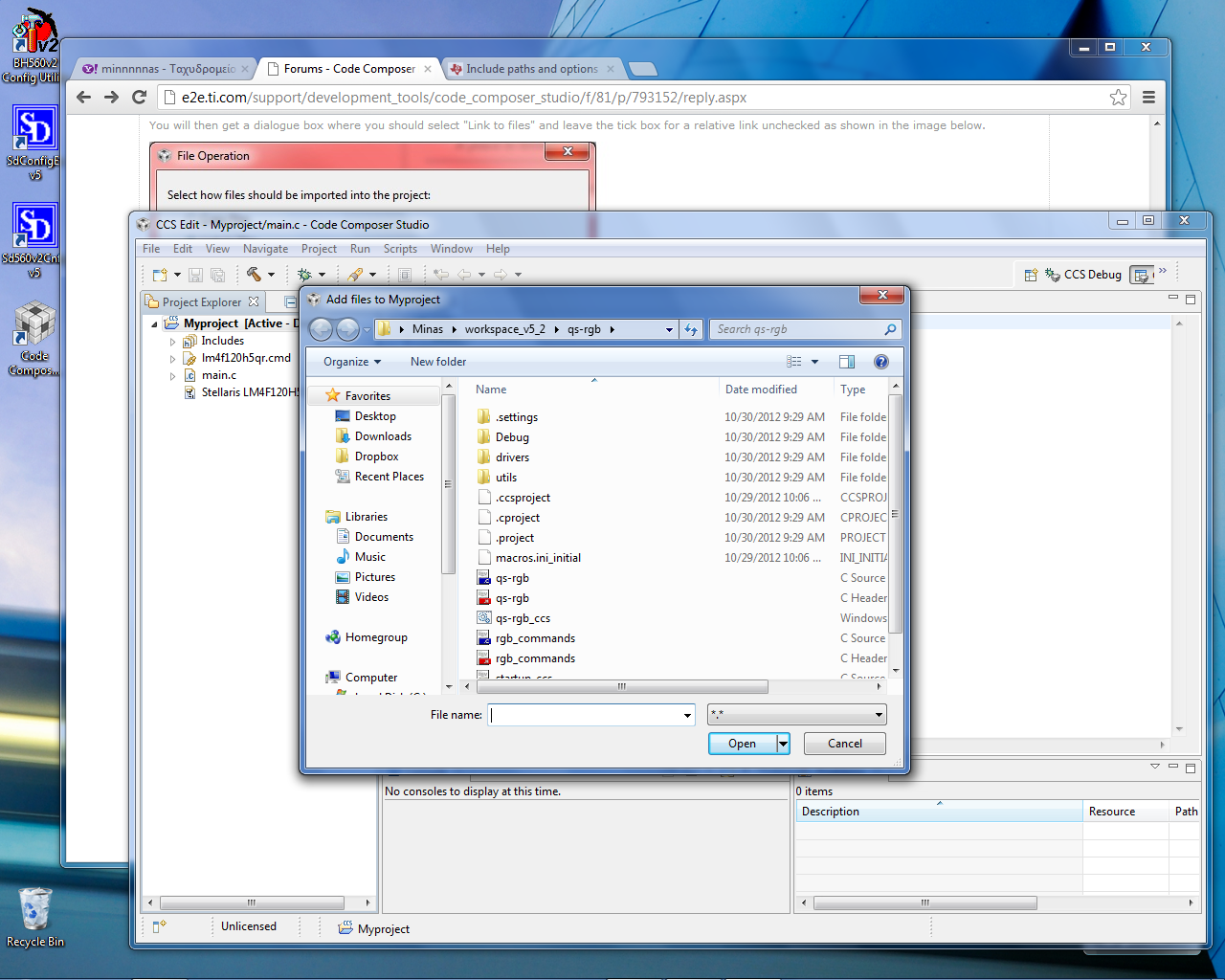

    This wiki points as first step to add files to my project. I'm right clicking on my project and then going to add files but it opens a search window where i should find which files i want to add. Nothing relative to what the wiki shows;
    The first step is to right click on the Project and select "Add Files".
    You will then get a dialogue box where you should select "Link to files" and leave the tick box for a relative link unchecked as shown in the image below.
    Can you please help me a little bit more? I'm totaly new to CCS and i don't know anything about it..
    Thank you in advance
    Minas
  • In my case when im clicking on Add files it opens this one
  • Hi Minas,
    this is correct.  You need to select or drag and drop the file in order to get that dialog box.    Linking = path to file stored, adding = copy of file added into the project.
    Hope this helps you a bit further.  There are some very good workshops and tutorials off of that wiki.
