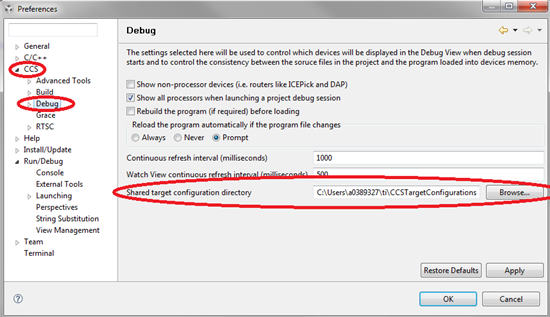

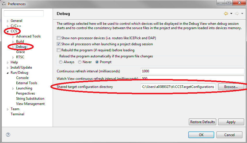

  • Is there some way that I can know the default location where CCS will look for the User Defined .ccxml files?
    If I knew that, I could programatially copy my ccxml there.
    I just did that manually, and everything works fine.
    Thanks!
    Go to 'Windows -> Preferences', then in the dialog:
    It tells you what the default is, and also allows you to change the default directory.
