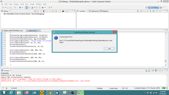

I am using CCS Version 5.4.0.00091 with the free license for the Stellaris Launchpad. I have a program that is 52K. When I try to debug,  it loads 32751 bytes and then stops. I then get the following error:
CORTEX_M4_0: Flash Programmer: Timed out while writing to Flash memory
CORTEX_M4_0: GEL: File: C:\TI-LaunchPad\EclipseProjects\GrlibAdaPjo\Debug\GrlibAdaPjo.bin: Load failed.

  • Hi Lisa,
     10Mhz gave me a freq. out of range error. 5Mhz gave the same load error I've been seeing.  Attached is the ccxml file (Renamed .doc for upload) and 2 screenshots. One is the 3 load dialogs right after it freezes. The second is the error dialog after the loading times out.
    Thanks again,
    Pat

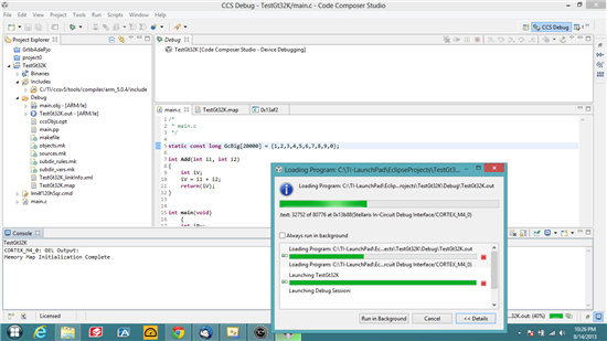

      Here ia a little more data. I created a simple useless program that has a global static const arrar of 80K bytes. When I declare this array of type char and 80K it loads fine and I can step through it. When I change the array type to long and 20K bytes it freezes during load as the other on has. Below is screenshots.
    Pat

  • Hi Pat,
    Thank you for the screenshots using which I was able to create a similar test case and reproduce the behavior with CCS locking up when trying to program to Flash. I tried the stand-alone flash programmer (Uniflash) as well and that generates the same error. This looks like a bug to me, so I have filed a bug report to track the issue. The tracking # is SDSCM00048029 and you may track the status using the SDOWP link in my signature.
    A workaround to avoid the issue could be to break down the array into smaller arrays.
