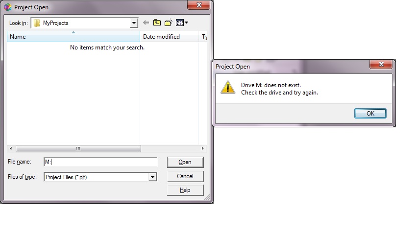

  • Ki, Here is the screenshots and error.  Each network drive I have mapped states "Drive X: does not exist".  Adding paths does not work (e.g., "M:\BSP" instead of "M:" or "M:\").   Also, C and D drives are the only visible still.
    Steps to recreate:
    1.  Start CCS v.3.3 in administrator mode.
    2.  Login with admin priveleges.
    3.   Select "Project"->"Open" in the Code Composer v.3.3 IDE.
    4.  Browse for a network share.
    5.   If #4 fails (it does), type in network drive letters, paths, etc.  Fails
     6.  Note: For the CCS v.3.3 install and first execution of the program,I ensured all options for the Windows Firewall were turned on  to allow for public, private, etc.
  • Please show me a screenshot of your mapped drives (usually a screenshot of the 'Computer' desktop icon). CCS does not think you have any mapped drives.
  • Ki,
         Thank you.  I solved the problem.  We can't have administrator rights in our individual accounts on the domain, so we have a special administrator account that is only valid for a short time that we have to log into for starting Code Composer.  My shares exist on my personal account, but not the administrator user account.  Therefore, if I run as a different user (administrator) in Windows 7, these shares don't show up or are accessible.
          Thanks for your help.  The solution is to try to get my personal account administrative privs.
