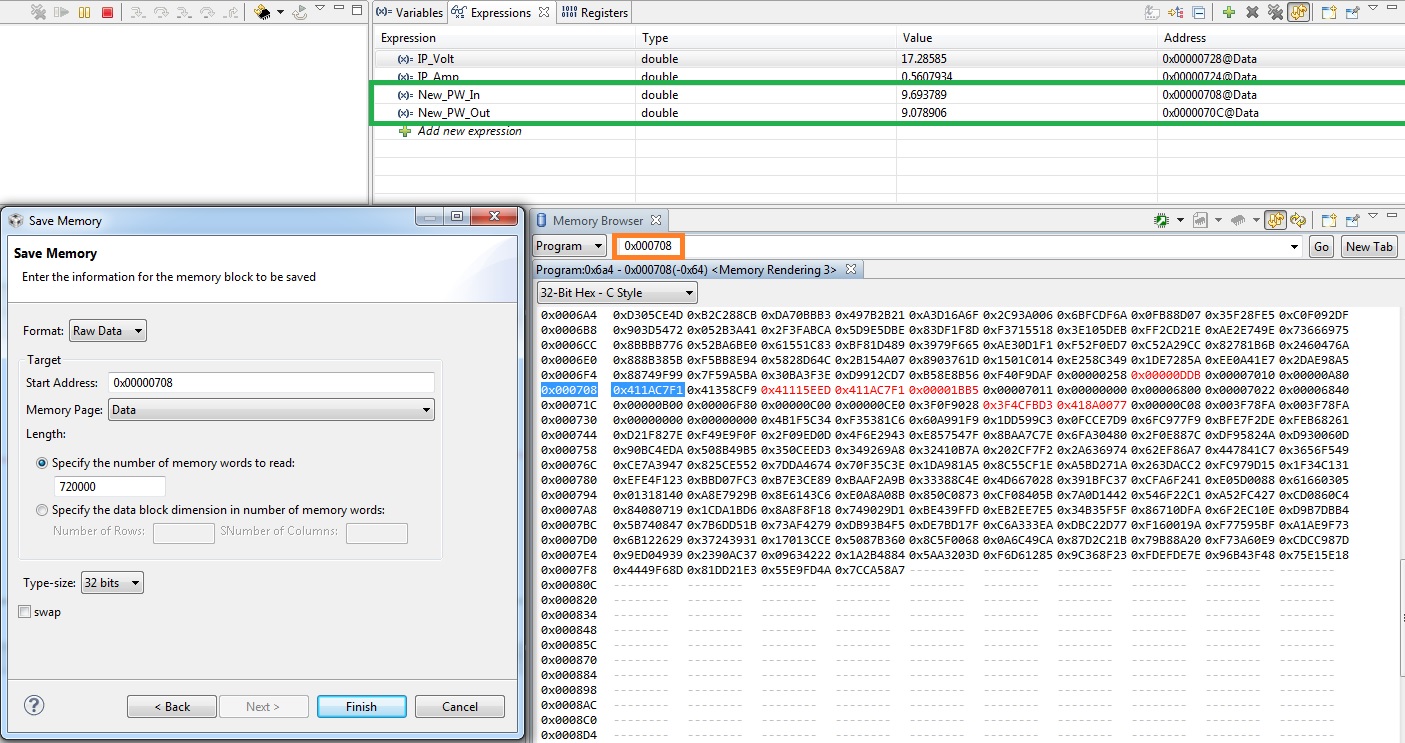

    Ok I have taken a couple of screen shots as having a few issues implementing the memory browser option, and have also tried to show the settings I am using for the graphing tool.
    1)  So the image below shows the memory browser screen capture, I am basically interested in storing the data from 2 variables (both doubles).  These are New_PW_In (memory address 0x00000708) and Old_PW_Out (memory address 0x0000070C), highlighted in the green box.
    I can find the memory location and view them constantly refreshing, the video link gives some indication of what to do but some of the settings are not really shown, so I am unsure if I am saving the correct information.  I also want to save roughly 10 minutes of data, and may increase this pending how I proceed.  I saved a .bin file but unsure firstly of the data content and also not found an easy way to open this yet, but that is another bridge to cross after I can get the data I want saved.
    Is there a better tutorial or some written documentation on using the memory browser to carry out the task I want to achieve, or can you provide a run through of what I need to do here?
    The image can be enlarged to read any detail that is necessary
    2) As mentioned already I have enclosed a further screen shot below. I again crudely timed 2 mins with my phone and trying to understand the units on the X axis, and how to give a meaningful value to them in relation to time?
