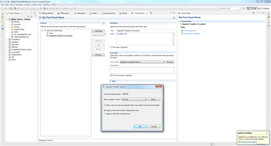

    I was able to get the command to run if I have a project selected in the Project Explorer.  Below is my environment.  I have the project "blinky" selected.  My cheatsheet editor is in the middle and my cheatsheet is on the right.  Ad the bottom you can see that the upgrade compiler dialog opened.

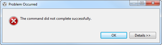

    I then opened the resource explorer and tried to run the command again and this time I got the error dialog.  The project still shows as active in my project explorer but I think context is lost somehow.

  • Yes, that is the exact error that I got. If i expand that error with the details button it tells me that the command is disabled. So I am assuming that the context is lost.
  • Yes that is what it says for me as well. If I click in the Project Explorer before running the command it is fine.  If I click in some other view first then it fails.
