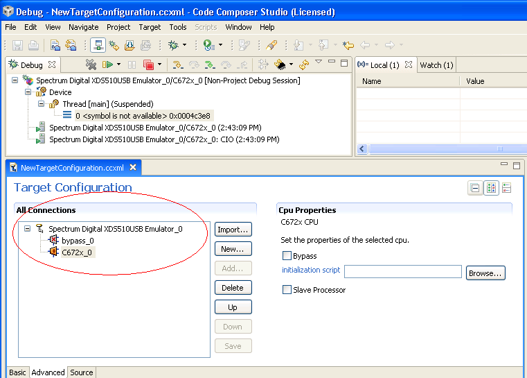

Is the 672X family supported under CCS 4.0?  I've tried over and over to create a "Target Configuration" for my Spectrum Digital 510 USB (which works just fine in CCS 3.3).
I added the SD 510 USB followed by the 672X CPU and then an 8-bit Bypass (to match the config from CCS 3.3).  I keep getting "Bad Target Silicon Revision Number" -- which is similar to what happens in CCS 3.3 when you forget to add the bypass device.
I've tried it with and without the bypass to no avail.
Is there an example for the 672X family?  I see no examples for a 672X configuration such as the Lyrtech PADK.
Has 672X support been dropped in CCS 4?

    C672x is supported with CCSv4. But you will have to use the advanced setup to create the target (see attached screenshot).
    I was successful with my DA708 EVM (C672x) using a SD 510 USB. Try adding the bypass first, then followed by the C672x (see screenshot).
    ki
  • First off, I don't see a screen shot.
    Secondly, I have already tried that many times (bypass first, then C672X) and and CCS4 will crash with an error.
    Here is the source-form of my config:

    Does your target configuration source match?

  • The screenshot is attached to my post, just under where is says:
    Ki-Soo Lee replied on Tue, Sep 8 2009 2:50 PM | 192.91.75.29
    Anyway, here is a direct link:
    http://e2e.ti.com/cfs-filesystemfile.ashx/__key/CommunityServer.Components.PostAttachments/00.00.03.83.02/672x.PNG
    The source from your xml looks like mine:

  • FWIW I gave this a shot with CCSv4 and my XDS510USB and was able to connect successfully. I built my own configuration in the Advanced tab but it matches up with Ki's. So it seems that the Lyrtech PADK is accessible via SD510USB. I *think* I have a Rev B board.
    I am curious if you (Alan) have verified the connection to the board using the SDConfig utility?
    *edit* I know it seems redundant at this point but here is my .xml content:
