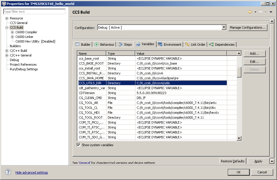

  • Peter Robertson said:
    That is clearly wrong, so how do I let the build process known where sh.exe is?
    According to Required non-Texas Instruments Software the mklib program uses the CCS_UTILS_DIR environment variable to locate the sh.exe.
    Looking at a CCS v6 example which successfully uses mklib to build a RTS library shows CCS_UTILS_DIR being set in the system variables:
    Has your project which fails to build the RTS library got a CCS_UTILS_DIR in the system variables?
