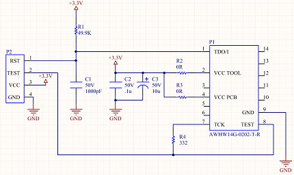

    here is schematic for my 14P to 4P converter PCB
    I was basing that on the diagram found in TI Literature Number SLAU278V MSP430 Hardware Tools User's Guide pg. 26. i do not populate R2. When i try to debug without the Target PCB connected i do get a low voltage error like the programmer does not have enough voltage, which seems ot me like the programmer is responding correctly.

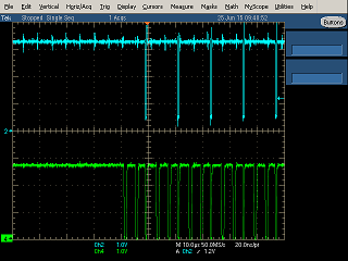

  • I got around to doing the scope and i see what may be the problem but i am not sure what the issue is.
    there are what appears 5 stages
    first a slow communication stage
    4 high speed communication stages
    i did not get a reading from the slow speed because i think the problem is in the final 4 high speed stages

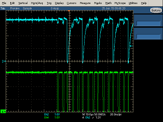

    this is stage 2. the first high speed stage after the slow communication. I can get a good solid 3.3V spike but then it doesnt give a solid 3.3V for a large portion. is this how the JTAG communication is supposed to look? Number 2[white] signal is RST and the number 4[yellow] is TST. i tried to focus the time scale and it looks the same.
    Here is stage 3 of the program cycle. after the stage 2 sequence, then stage 3 begins. this one however can cause the RST line to get up to 3.3V.
    Here is stage 4. failure for RST to get to 3.3V again
    Here is stage 5. semi failure. it seems to be able to hit 3.3V just not well.
    In my previous post i gave the schematics of my system. i removed C1 so now i have a direct connection between RST between the 2 PCBs. is this the signals I should be seeing. or does anyone know what these signals are indicative of? did i blow out my chip? or is the programmer broke? i will replace the chip, but any help would be appreciated.

  • Dominic,
    Glad you were able to solve your issue by shortening the wires between the programmer and your board. The SBW interface is timing based and to much impedance in the line can cause issues. In regards to 2wire (SBW) vs 4wire (Normal JTAG), the debugger + CCS will automatically detect the method to use. You can actually force the FET-PRO430 SW to program in either mode. As to firmware version on the FET. The program controlling the FET will try to re-program it to the known good firmware the program knows. The latest version of the FET firmware will automatically be downloaded to the FET if using CCS and CCS is up to date. If you know you have the latest FET firmware, you can cancel the automatic FET Firmware download and program normally.
