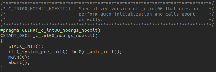

The startup routine _c_init00_noargs_noexit calls either _auto_init or _auto_init_hold_wdt for auto initialization (with or without watchdog timer) which also depends on the target mcu.
But when I examine the corresponding source and object file (boot_special.c, boot_special.obj) it seems like _auto_init is always called.
Using the readelf tool I get the following relocation entries for the library function _c_init00_noargs_noexit (boot_special.obj):
The third relocation entry seems to belong to the _auto_init function.
Also within the source code (boot_special.c) the call "_auto_init()" just belongs to the normal _auto_init function defined in autoinit.c.
When compiling my program for the target mcu msp430f1611 I get the following disassembly:
Now, _auto_init_hold_wdt  is called and it seems for me as if the _auto_init symbol was magically replaced with _auto_init_hold_wdt.
I cannot understand where the replacement of the symbols took place. Maybe after the compilation process by the linker?

  • These symbols are special. The linker does some optimizations with them when certain conditions are met. For instance, the compiler never generates calls to the hardware multiply functions, it always calls __mspabi_mpyi. If you use the --use_hw_mpy option, the linker will rewrite reloctions to __mspabi_mpyi so that they are now relocations to one of the hardware functions. In a similar way, relocations to _auto_init are rewritten as relocations to _auto_init_hold_wdt, etc. Then, normal relocation happens and you see the updated references in the disassembly.
