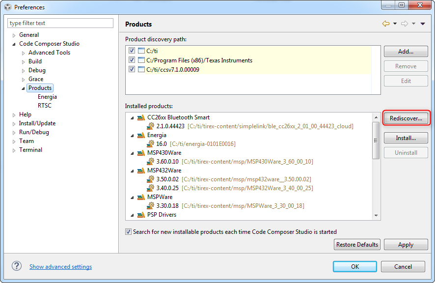

    Ralf Koester said:
    CCS did not find the new tool, although I close the CCS.
    Only when I openden another workspace CCS recognized the new tool and finalized the installation process.
    It could be that you disabled the auto-discovery feature when launching CCS with the old workspace. You can always force a rediscovery via the button below:
    ki
