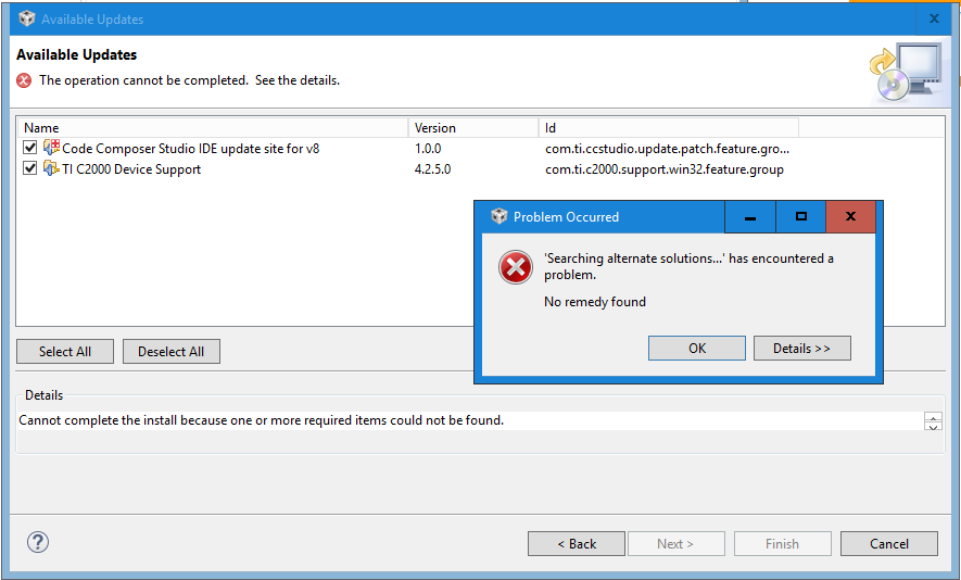

I just installed CCSv8 and when checking for updates I got below message:
Any idea?

  • Hello again
    Once again as text:
    When checking for update I get a box indicating available updates with the info "The operation cannot be completed. See the details." and at the same time an info-box pops up with
    "Problem Occurred" in the titel and the description "'Searching alternate solutions...' has encountered a problem. No remedy found"
    I try attaching again below.
    Lars
  • Lars,
    Could you try scrolling the box where it says "Cannot complete the install because one or more items could not be found"? I have a feeling that the C2000 device support you're trying to install may not be relevant for your 8.0 installation.  Unfortunately, eclipse doesn't always give the best messages.

  • Sorry for the late answer... I was too busy with other tasks.
    I have ticked away one of the suggested updates (I think it was the TI C2000 device support) and planned to install this in a second run, if the first update now could install, which it did.
    When again checking for updated the TI C2000 Device support was not more suggested, nor anything else.
    So I now have a running CCS that should be up to date...at least it say so.
    So i think this is solved.
    Thank you for getting involved!
