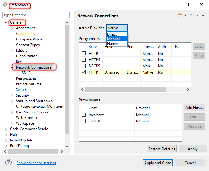

  • Wayne Huang said:
    That is, I do not see the setting on CCS 7/8.
    This setting is available on both CCSv7 and v8 under 'Window -> Preferences'
    ki
  • Ki,
    Thank you for your information.
    This customer's antivirus is also from TrendMicro....
    After testing, we find disconnecting CCS network automatic connection showed in the last post does not help.
    Instead, the workaround other posts mentioned (that you also mentioned in the beginning) works.
    e2e.ti.com/.../701209
    That is, by manually disabling Makefile auto-generation in the setting (in Project->Property->Build/Builder ) and then remove the SHELL=cmd.exe in the Makefile that has been generated.
    This is somewhat troublesome, but can be a workaround at this moment.
