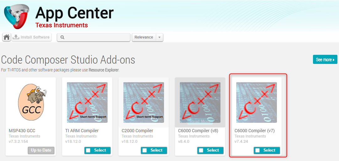

            I have installed CCSv7.4_win32 on my PC. when i choose device TMS320C6713 in my new project, it says "The device is no longer supported by the compiler of version 8.0.0 or higher". Here, 7.4 compiler version option is not available in project settings. The snapshot of corresponding problem attached above. Anybody can resolve this problem.
    Thanking you,
    C6000 CGTv7.x does not come with CCS by default (anymore). But you can get it from App Center (View -> CCS App Center)
