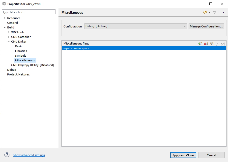

  • We may have to loop in someone from the product line or RTOS team.  For me I was running a bare metal application.  In that case the libraries were controlled directly in the project settings.
    These captures are from a different machine, just showing where the settings are.  If nosys is specified as a library I think that will cause problems.  Similarly --specs=nano.specs would be an issue under miscellaneous.

  • It seems like both nosys and nano.specs are to some degree needed for the program to build.
    No nosys produces a lot of undefined references to things like _open, _kill, _getpid.
    No nano.specs causes the program to crash in the same case as in my last post, so perhaps some extra option or something is needed to get it work with full newlib.
  • Thank you, Todd, but following those instructions made no difference, unfortunately.
