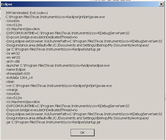

CCS 4.2 fails to load program on XDS510PP (newly developped again)
I am using CCS 4.2.5.00005 and loading a C6748 using an XDS510PP.
I have been working with this system for about a year. Every few months this situation re-occurs and I am usually able to fix it, but no luck this time (so far).
Problem:
I am able to connect to the device and load the configuration GEL file successfully, but when I try to load the program, it partially loads (anywhere from 0-60%) and then CCS crashes. Below is one of the terminating splash screens.
Usually, by downloding the lastest software, cleaning and rebuilding all projects, and playing some games with the selection of the out file it has come back, but not this time.
For verification I have used a second emulator and boardset, I have tried the -clean for the workspace, increased the heap size (-Xmx512m) and renamed the ctools.dll (which had been recommended), all to no avail. I am also attaching a log file from ccs4\emulation\analysis\bin. I am open to suggestions! Thanks in advance.
Dan.

VM Arguments:
jvm_args: -Xms40m -Xmx512m -XX:MaxPermSize=96m -DXPCOM.RUNTIME=C:\Program Files\Texas Instruments\ccsv4\DebugServer\win32 -Dxpcom.bridge.executeOnDedicatedThread=no -Dorg.eclipse.swt.browser.XULRunnerPath=C:\Program Files\Texas Instruments\ccsv4\DebugServer\win32 -Dosgi.instance.area.default=file:/C:/Documents and Settings/dbishop/My Documents/workspace/
java_command: C:\Program Files\Texas Instruments\ccsv4\eclipse\startup.jar -os win32 -ws win32 -arch x86 -launcher C:\Program Files\Texas Instruments\ccsv4\eclipse\eclipse.exe -name Eclipse -showsplash 600 -exitdata 1264_c4 -clean -vm C:\Program Files\Texas Instruments\ccsv4\eclipse\jre\bin\javaw.exe -vmargs -Xms40m -Xmx512m -XX:MaxPermSize=96m -DXPCOM.RUNTIME=C:\Program Files\Texas Instruments\ccsv4\DebugServer\win32 -Dxpcom.bridge.executeOnDedicatedThread=no -Dorg.eclipse.swt.browser.XULRunnerPath=C:\Program Files\Texas Instruments\ccsv4\DebugServer\win32 -Dosgi.instance.area.default=file:/C:/Documents and Settings/dbishop/My Documents/workspace/ -jar C:\Program Files\Texas Instruments\ccsv4\eclipse\startup.jar
Launcher Type: SUN_STANDARD

  • OK...
    Once again (as it also happened about 6 months ago), my posting has seemed to contribute (in some karma-like way) to me getting it working again!
    The only thing different that I believe I did (apart from copius amounts of re-booting) was to rebuild the first project in my workspace (along with all the others). Although this project was not a dependancy of the top-level project that I was trying to load, rebuilding it may have rejoined the gap in the CCS4.2 space-time continuum and allowed life to continue.
    I will rest judgement for a few working days...
    Happy Friday!
    Dan.
  • It happened again yesterday after a debug session failed while running. The initial rebuilds and rebooting did not work, but I performed a re-boot with the parallel port cable disconnected from the emulator, performed the "-clean" on startup, rebuilt, crossed my fingers, and it is back again.
    I think it is safe to guess that the root of the problem may rest with CCS4.2's ability to interact with the emulation driver, there may be timeout issues or something of this nature.
    The error on close seems to be referring to Java issues.
    All for now.
