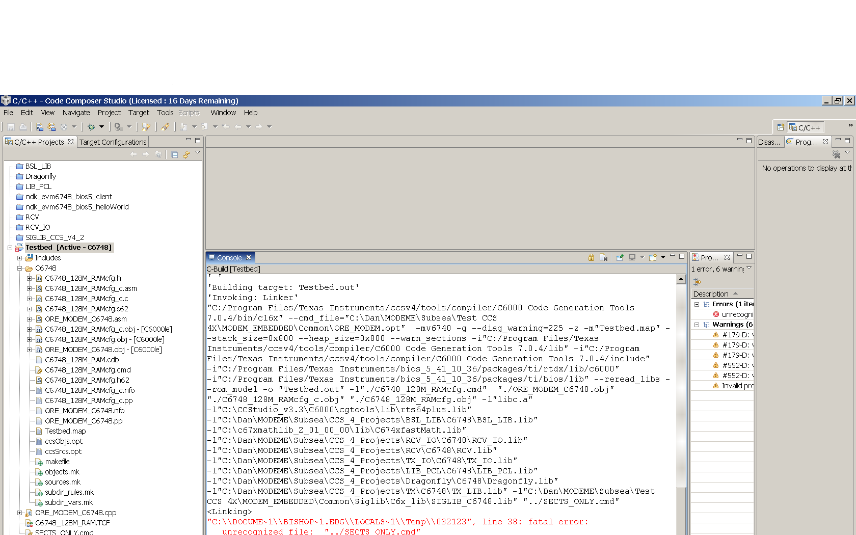

  • Hello Desouza,
    If you look back at the beginning of this problem I have been unable to add a .cmd file to the project. No matter how I try adding it, the project will not acknowledge it as a valid file.
    Dan.
  • Dan,
    Can you add the custom linker command file to the project by rgiht-clicking on project name and choosing Add Files, then capture a screenshot of the C/C++ Projects view in CCS and attach it here? Also please post the complete output of the build console after adding this linker command file to the project.
  • Hi Aarti,
    The command file is called "SECTS_ONLY.cmd" and was added as you mentioned. Below is the output. You can see near the bottom that it does not accept the CMD file.
    I'm not sure how to attach a screen shot on this website. I tried pasting it below with no luck.

    Screen Shot:
  • Dan,
    I've been trying to create a similar environment but I can't duplicate the linker error. Are you able to attach your project here, or if you cannot post it to a public forum, can you send it to me via private conversation? If you can, please export your project per the procedure described here: http://processors.wiki.ti.com/index.php/Project_Sharing
