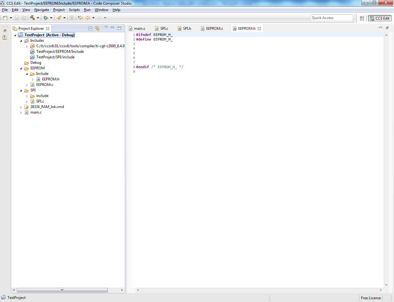

  • Ok, now I understand. "Includes" is not actually a folder. Its only purpose is to show you all of your include paths.
  • Thats good its clarified what I was thinking. It means I either have to have header files mixed with source files all under the source folder or do as I do and manually move them into the header files ( Include ) folder within the project folder on hard disk. I'm sure there must be an automatic way to do this but all searching so far hasn't found anything. I think its time to retire as my thinking is "Includes" should have the same attributes as the Source folder, hence the same menu capability and file creation ability.
    You mention above Stephen how Includes is simply meant to show all your include paths but all files are still click editable from it so it does have folder properties to some extent but not at the top level as per Source.
  • I am using CCSv6.01.0040 and with the exception of  standard library include files, I am not able to access or see any of the header files within "Includes".  However, I am able to access and see the standard library include files (stdio.h and etc.).

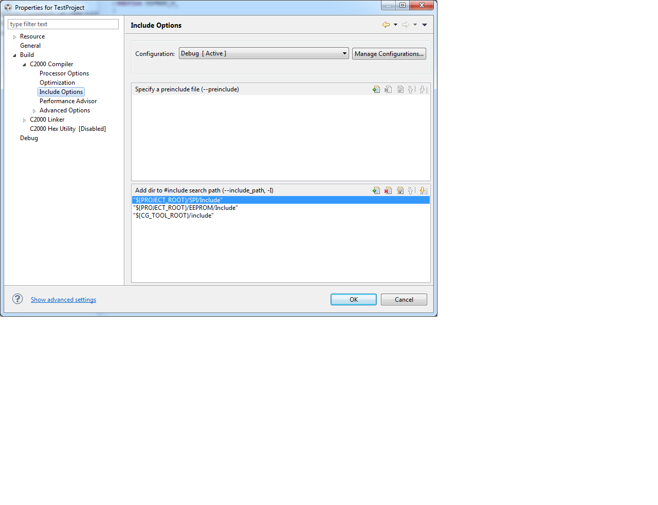

    You don't need to mix the header files with the source files.  Please see example project I made up below.  I added the include files by right clicking on the specific folders I wanted the include files to be in and selected New->Header Files.   "Includes" will show all the include paths as specified in the Include Options located in the project properties.  I also included the the Example Project's Includes options below.
  • Thanks Stephen( I used this name, hopefully correctly, from your first mail reply but notice you have Steven on your user id ), I've just added folders in the project and in effect created my own structure similar to your own. That works as I knew to set up the include path so as to see the include files in the CCS "Includes" display and allow files to be read in at compilation. My own project is a legacy CCS 3.3 import from another company and CCS created a folder Source, my failing was in thinking that CCS would understand that the extension .h should be saved into an include file folder that the user could browse for. In my case that being the folder where the main 28335 headers are kept( for now anyway that will change ). I think thats sorted, basically CCS needs to have folders created and it doesn't mind what file you create in them, you could mix all extension types. CCS doesn't look to putting .h files in folders having "Include" file oriented attributes, they're all just simple folders and setting the include paths allows all headers to be viewed via the shortcut "Include" tab in the display( as well as providing the search path for compile ). This "Include" tab can't be set as a folder as beneath it are directories that can bear no relation to each other in terms of a common root directory. Its purely representational and a shortcut access to all header files in the project. Thanks for that.
