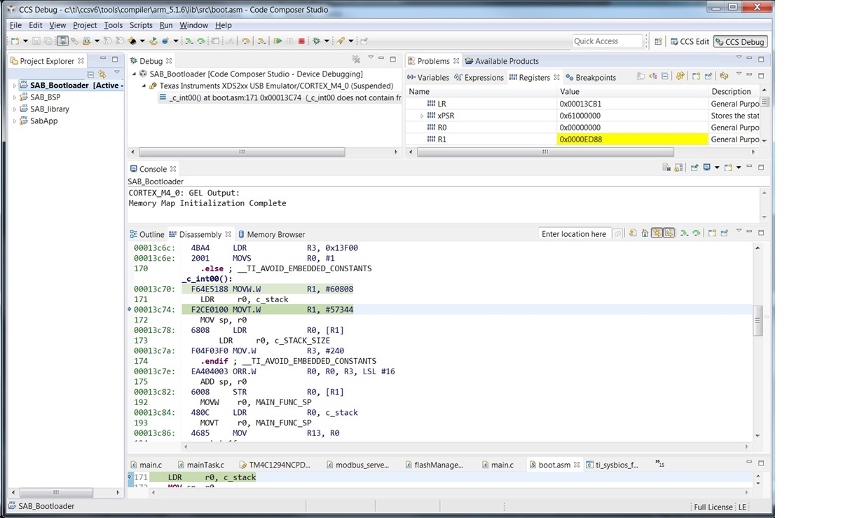

I have an issue with a part that does not work.  We are trying to debug using disassembly and source to find out why the hardware is broken. CCSv6 displays source for the boot.asm in c:\ccsv6\tools\compiler\arm_5.1.6\lib\src.
However, the application was obviously built using boot.asm from c:\ti\tirtos_tivac_2_00_01_23\products\bios_6_40_01_15\packages\ti\targets\arm\rtsarm.
So, how do we tell CCv6 how to use the right file for both source debugging and interspersed disassembly/source? It would seem that the map file or the debug file should have the correct path, but obviously it does not.

  • Here is a screen shot. You can see that the disassembler thinks it is at line 171 of boot.asm with an instruction "LDR r0, c_stack" when the actual machine code is loading 0xed88 into R1.

    Yes the symbols were loaded. You can see that because CCSv6 actually knows that we are at _c_int00. It just thinks the source code is somewhere else.
    It also looks very much like none of the boot.asm files in my tree are what is actually used to build my image.  There are two versions in the ccsv6 tools path and two in the tirtos path and it appears that none of them is actually what is in my image.
    The closest version of boot.asm that seems to have been used appears to be the one from ti\tirtos_tivac_2_00_01_23\products\bios_6_40_01_15\packages\ti\targets\arm\rtsarm.  The code that exits the assembler preprocessor actually appears to start at line 159 (conditional assembly becomes TRUE at the .else) with actual code beginning at line 169. However, you can see from the disassembly that CCSv6 incorrectly thinks it is at line 171.

    I can reproduce this with TI-RTOS examples. It looks like the source look up path in CCS defaults to the boot.asm in the compiler's library folder even for TI-RTOS projects which it should not. I will submit a bug for this.
    There are a couple of ways to add additional source lookup paths to CCS. One way is to go to menu Run->Debug Configurations, select your debug configuration in the left pane (it will be the name of your project or target config file) and go to the Source tab in the right pane. Click on Add, select File System Directory and browse to the rtsarm folder within TI-RTOS. The click on "Up" to make that appear before RTS Library Source in the list. Now the debug session should reflect the correct source lookup.
