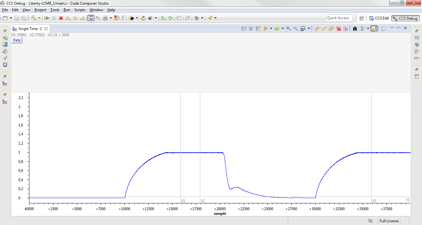

How can I display the y values? It only displays x values and after try to put an y marker, it stops display the values of x marker too (x3 marker).

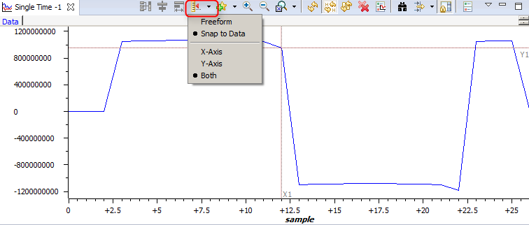

I do see that the Measurement marker for Y-axis does not work as well as the X-axis. Setting the Measurement Marker mode to "Both" (as in screenshot below) seems to do ok with setting the marker on both X-axis and Y-axis but the values are still not displayed consistently. Note, in my case, although it seemed that "Both" was selected by default, I had to select it again to be able to set the marker on both axes.
I will file a bug report about the Y-axis markers. Sorry about the inconvenience.
