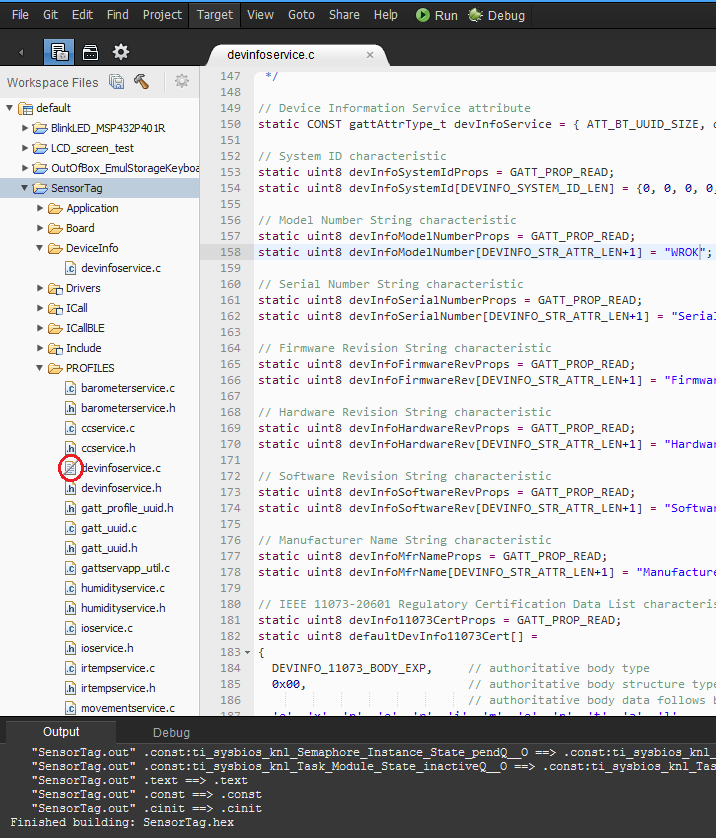

but I get stuck each time at the linker with
error: symbol "DevInfo_AddService" has already been defined
error: symbol "DevInfo_SetParameter" has already been defined
error: symbol "DevInfo_GetParameter" has already been defined
error: symbol "devInfoServUUID" has already been defined
error: symbol "devInfoSystemIdUUID" has already been defined
error: symbol "devInfoModelNumberUUID" has already been defined
error: symbol "devInfoSerialNumberUUID" has already been defined
error: symbol "devInfoFirmwareRevUUID" has already been defined
error: symbol "devInfoHardwareRevUUID" has already been defined
error: symbol "devInfoSoftwareRevUUID" has already been defined
error: symbol "devInfoMfrNameUUID" has already been defined
error: symbol "devInfo11073CertUUID" has already been defined
error: symbol "devInfoPnpIdUUID" has already been defined
error: symbol "devInfoCBs" has already been defined
>> Compilation failure
fatal error #10192: Failed linktime optimization
>> Compilation failure
Clearly this is due to duplication, but how does this happen?
ie where am I going wrong?

  • Hi Simon,
    If I had to guess, I would say that you missed the step where you have to exclude the original file from the build. the original file should have the icon next to it that shows that it has been excluded:
    Can you confirm this?
    ki
  • Thanks ki,
    it was the kick up the backside I required. The problem was not that I hadn't forgot to exclude from the uploaded code, but because I've had issues with the firmware updates, I'd forgot that I have put other of my own directories and forgot to remove them/exclude them. Now I have a clean build this step works., now I have to figure how to keep it going for longer.
