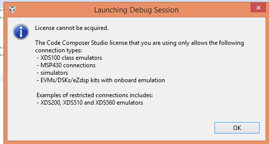

CC6.2 and segger J-link edu version
i'm working a lot with TI products and after some time i switched do KEIL and now decided to also include CCS into development process because it's based on Eclipse.
I saw that CCS6.1 does support the Jlink interface (im using Jlink EDU).
On segger site, some information can be found that segger is cooperating with TI to improve jlink and overall segger products support.
For now, is in CCS 6.2 license will be required for debugging thru segger? Right now i'm able to download the code thru j-link edu version using CCS but not to debug the code in, how about in the future?
