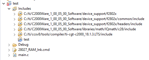

I create a new ccs project,i get error
**** Build of configuration Debug for project test ****
"C:\\ti\\ccsv8\\utils\\bin\\gmake" -k -j 2 all -O
Building file: "../main.c"
Invoking: C2000 Compiler
"C:/ti/ccsv8/tools/compiler/ti-cgt-c2000_18.1.3.LTS/bin/cl2000" -v28 -ml -mt --include_path="C:/ti/C2000Ware_1_00_05_00_Software/device_support/f2802x" --include_path="C:/ti/C2000Ware_1_00_05_00_Software/device_support/f2802x/common/include" --include_path="C:/ti/C2000Ware_1_00_05_00_Software/device_support/f2802x/headers/include" --include_path="C:/ti/C2000Ware_1_00_05_00_Software/libraries/math/IQmath/c28/include" --include_path="C:/Users/shad/workspace_v8/test" --include_path="C:/ti/ccsv8/tools/compiler/ti-cgt-c2000_18.1.3.LTS/include" -g --diag_warning=225 --diag_wrap=off --display_error_number --preproc_with_compile --preproc_dependency="main.d_raw"  "../main.c"
Finished building: "../main.c"
Building target: "test.out"
Invoking: C2000 Linker
"C:/ti/ccsv8/tools/compiler/ti-cgt-c2000_18.1.3.LTS/bin/cl2000" -v28 -ml -mt -g --diag_warning=225 --diag_wrap=off --display_error_number -z -m"test.map" --stack_size=0x300 --warn_sections -i"C:/ti/ccsv8/tools/compiler/ti-cgt-c2000_18.1.3.LTS/lib" -i"C:/ti/ccsv8/tools/compiler/ti-cgt-c2000_18.1.3.LTS/include" --reread_libs --diag_wrap=off --display_error_number --xml_link_info="test_linkInfo.xml" --rom_model -o "test.out" "./main.obj" "../28027_RAM_lnk.cmd"  -llibc.a
<Linking>
 undefined              first referenced
  symbol                    in file
 _ADC_init              ./main.obj
 _CLK_enableAdcClock    ./main.obj
 _CLK_init              ./main.obj
 _CLK_setOscSrc         ./main.obj
 _CPU_clearIntFlags     ./main.obj
 _CPU_disableGlobalInts ./main.obj
 _CPU_init              ./main.obj
 _FLASH_init            ./main.obj
 _GPIO_init             ./main.obj
 _PIE_disable           ./main.obj
 _PIE_disableAllInts    ./main.obj
 _PIE_init              ./main.obj
 _PLL_init              ./main.obj
 _PLL_setup             ./main.obj
 _PWM_init              ./main.obj
 _WDOG_disable          ./main.obj
 _WDOG_init             ./main.obj
error #10234-D: unresolved symbols remain
error #10010: errors encountered during linking; "test.out" not built
>> Compilation failure
makefile:141: recipe for target 'test.out' failed
makefile:137: recipe for target 'all' failed
gmake[1]: *** [test.out] Error 1
gmake: *** [all] Error 2

  • How did you created your example?
    Could you import TI example and build it?
  • I create a new ccs project and then attached the headers file
  • Comment out your modifications and try to build an empty project.
  • I create whole new project .
    sir,can u guide me how to add all necessary files to this and what are the necessary files????
    thank sir
  • Could you comment out your modifications and try to compile?
  • yes it is successfully compiled
  • Ok,
    than add paths to header files you need and try to build,
    also post main.c
  • sir,how can I add paths to header files
  • Please show your main.c.
    Build project and show console output.
    You need to learn from this document: dev.ti.com/.../

    console
    **** Build of configuration Debug for project test_ ****
    "C:\\ti\\code composer\\ccsv8\\utils\\bin\\gmake" -k -j 4 all -O
    "C:/ti/code composer/ccsv8/tools/compiler/ti-cgt-c2000_18.1.1.LTS/bin/cl2000" -v28 -ml -mt --include_path="C:/Users/vecmo/workspace_v8/test_" --include_path="C:/ti/c2000/C2000Ware_1_00_05_00" --include_path="C:/ti/code composer/ccsv8/tools/compiler/ti-cgt-c2000_18.1.1.LTS/include" -g --diag_warning=225 --diag_wrap=off --display_error_number --preproc_with_compile --preproc_dependency="main.d_raw" "../main.c"
    >> Compilation failure
    subdir_rules.mk:9: recipe for target 'main.obj' failed
    "../main.c", line 4: fatal error #1965: cannot open source file "DSP28x_Project.h"
    1 catastrophic error detected in the compilation of "../main.c".
    Compilation terminated.
    gmake: *** [main.obj] Error 1
    gmake: Target 'all' not remade because of errors.
    **** Build Finished ****
  • You need to link driverlib.
  • Aash,
    If you are creating a new project from scratch rather than using one of the example projects from C2000Ware as a starting point, then open one of the example projects and use it as a reference. In particular, make sure that the compiler include paths and linker search paths and libraries match up with the examples. Note that the INSTALLROOT_F2802x variable referenced in the examples is a variable that is automatically set to a specific device directory inside C2000Ware. If you are creating a new project from scratch you would need to create this variable yourself (refer to this page for more on variables).
    Finally, as Tom mentioned, make sure to add or link driverlib.lib to your project to resolve the undefined symbol linker errors.
