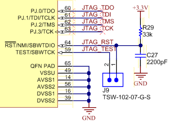

    Thanks for your detailed post. The FDC2214EVM does have a JTAG interface where you can solder a header for easier access. Looking at the FDC2214EVM's schematic, J9 brings out the JTAG SBW signals, Reset and Test. If you have a MSP-FET debugger, you could use short jumper wires to connect to these SBW signals and VCC target (or supply) on the MSP-FET and GND for programming the MSP430F5528. An alternative to the MSP-FET would be using the on-board debugger (part above the isolation jumpers) on one of our newer LaunchPads, such as the MSP-EXP430F5529LP, to program your EVM.

    Yes. You'll need to solder a header to J9 on the FDC2214EVM. Then, you can use jumper wires to connect J9 to the MSP-FET pins, which you can access after removing the 14-pin cable. For the correct connections, you'll need to refer to the MSP430 Hardware Tools User's Guide and the FDC2214EVM's schematic. Basically, you'll need the two SBW connections plus GND and the FDC2214EVM's VCC (connected to VCC target on the MSP-FET).

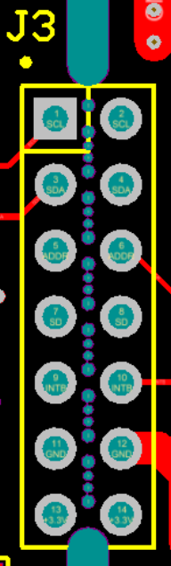

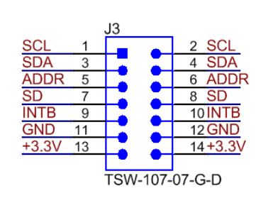

    Thanks for your kind feedback! Looking at page 50 in the FDC2114 and FDC2214 EVM User’s Guide, I see that the part number for the J9 header is TSW-102-07-G-S (made by Samtec) and is described as "Header, TH, 100mil, 2x1, Gold plated, 230 mil above insulator".
    Since the through-hole spacing on J3 is the same (100mil), you could solder another 2-pin header on pins J3.11 and J3.13 or J3.12 and J3.14 to easily connect your jumper wires to GND and +3.3V on the FDC2214EVM.
    Thus, you'll probably want to order at least two of these headers.

  • J9: SBW Reset and Test
    J3: +3V3 and GND

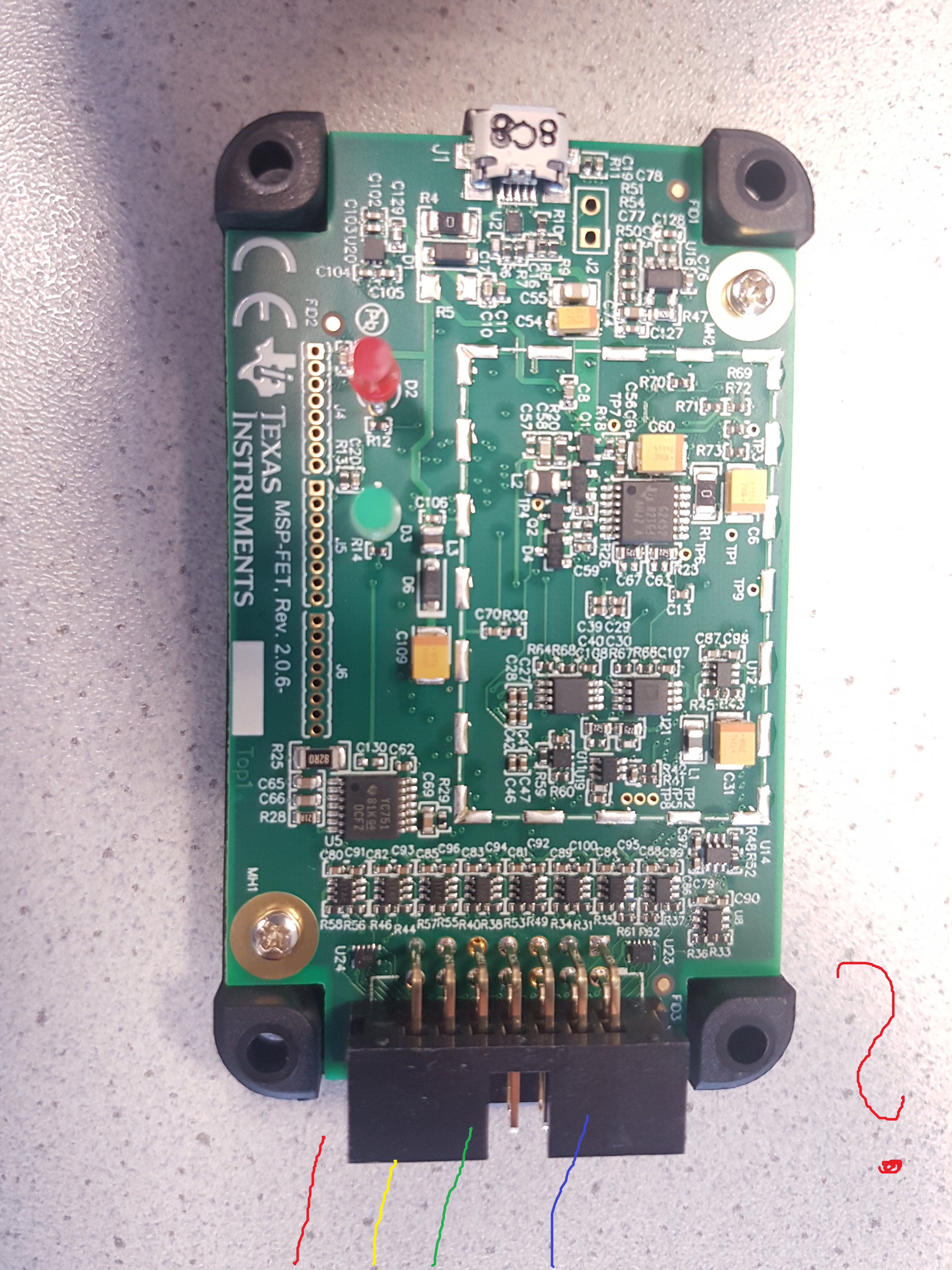

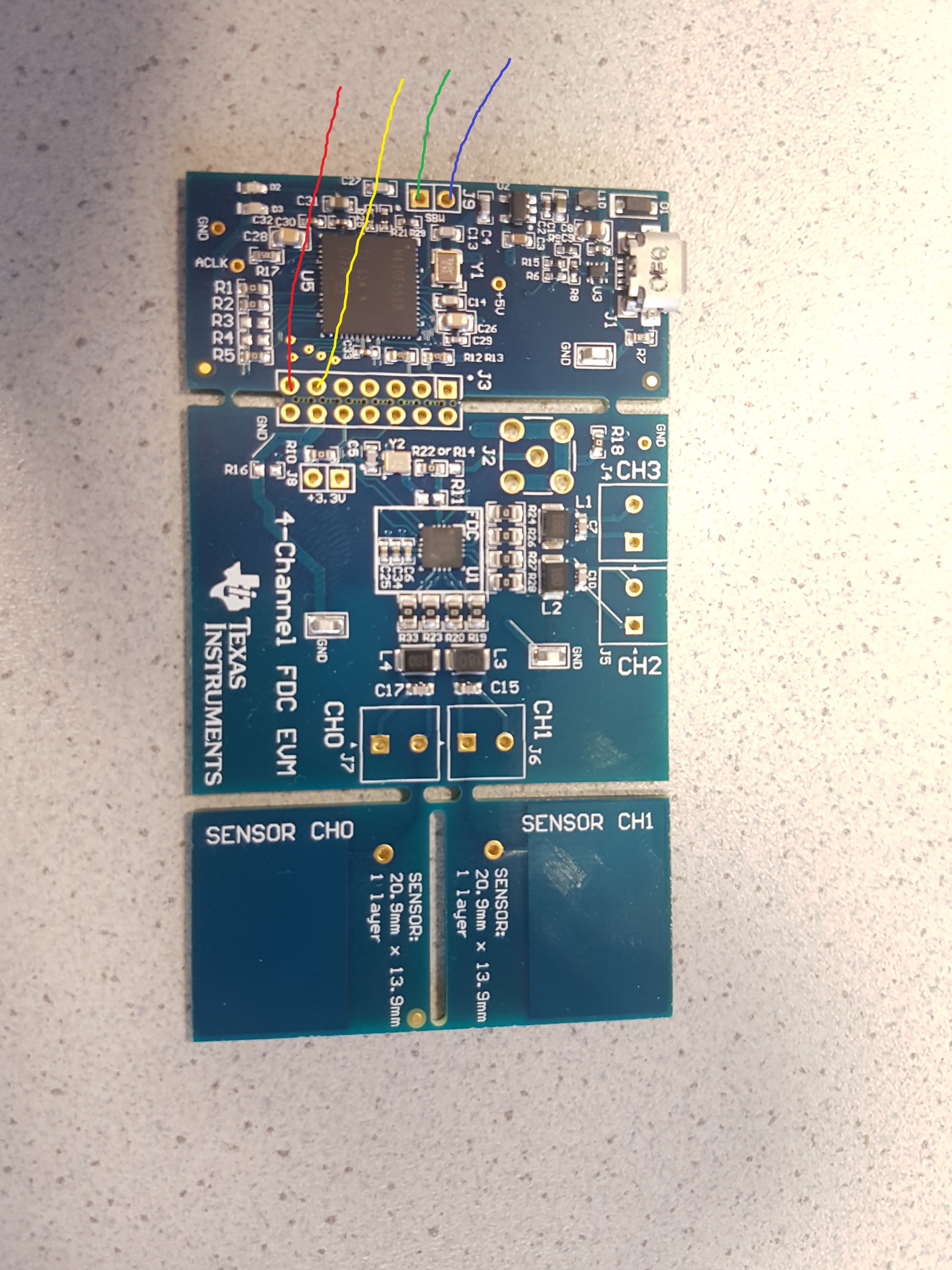

  • Hey James,
    i got my MSP-FET now. It currently looks like this. The 2 2-pin header for J9 and J3 are also ordered. Can you maybe just draw in where i put my wires from the EVM to the FET? I'll show you how i understood it should be. I go out from J9 and J3.13 J3.11 from the EVM. Then i connect the 4 wires to the J3 from FET. But i dont get which wire is the right to connect with the FET.
    Marius

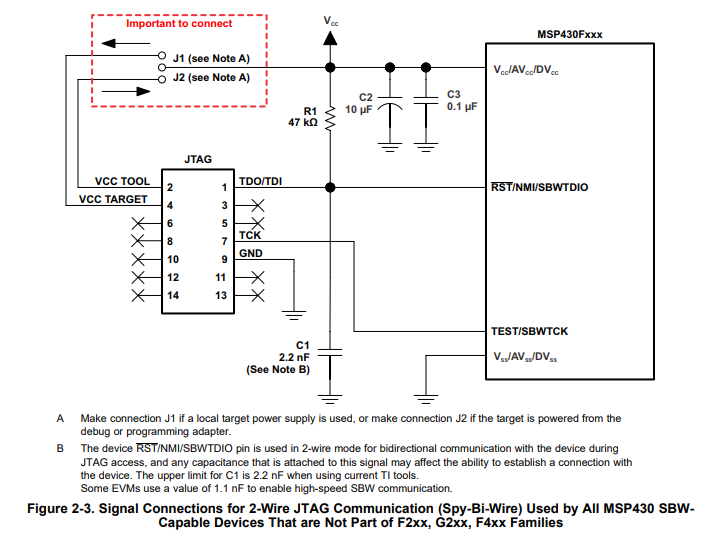

  • Hi Marius,
    Please refer to Figure 2-3 in the MSP430 Hardware Tools User's Guide for the MSP-FET connections. If you plan on powering the EVM from the MSP-FET, you'll want to use "VCC_TOOL". If you're using an external power supply, then use "VCC_TARGET" instead. Refer to the diagram underneath the MSP-FET's housing for the pin versus connector key orientation. Besides supply voltage, you'll want to connect to Pin 1, 7, and 9.

  • Hi James,
    thanks. I nearly understood all connections now. Only one left are GND and 3.3V from the EVM. Where do i put them on the MSP-FET? Pin 1 and 7 are 100% clear and also is J1/J2. And which connection is number 9?
    Marius
    Please see my earlier reply about powering the EVM and refer to the Figure above for identifying the pins.
