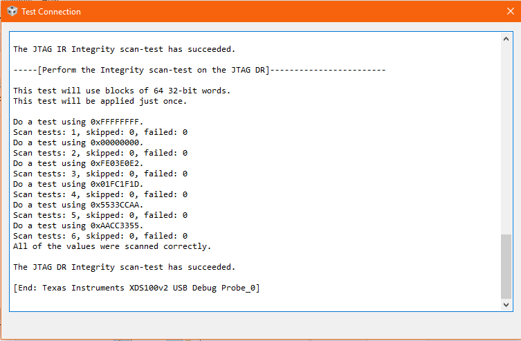

Recently I Bought a new C2000 LaunchPad XL TMS320F28027,but i am facing a flashing/debugging problem Every time I connect my  Board to laptop the test connection is working successfully but as when flashing/debugging is done the following error comes up:-
IcePick_C_0: Error connecting to the target: (Error -2131 @ 0x0) Unable to access device register. Reset the device, and retry the operation. If error persists, confirm configuration, power-cycle the board, and/or try more reliable JTAG settings (e.g. lower TCLK). (Emulation package 8.3.0.00003)

  • Hey Rafael,
    I think the configuration setup is set for F28027 ,for your reference I have attached the screenshot of the configuration below and also for the successful test connection,After your post i have reset the configuration but the error happens to br the same.
    Can you Please suggest what should I do to solve this problem

  • Rahul,
    Thanks for sending the pictures. Can you launch the configuration manually?
    - In the Target Configurations view, right click on the F28027.ccxml file and select Launch Selected Configuration.
    - After launch, right click on the core "Texas Instruments XDS100v2 USB Debug Probe_0/C28xx" and select Connect. At this point the core should connect and be halted at a certain point in the Flash.
    If that is not happening, what is the error message? Also, can you send a photo of your board? I just want to be sure how it is connected.
    If that works, can you try to load a different project to the device? My suspicion is that there is something wrong going on with the project that is causing the processor to fail immediately after loading - usually the project runs to main after loading but, if the project is somehow misconfigured, the Debug Probe will lose control over the device.
    Rafael

  • Rahul,
    Thanks for sending the additional details.
    1. The message shown is normal. It shouldn't affect the ability to load code to the device. At this point the device is stable and properly connected.
    2. How are you loading code? I am doing the following (discard the error; it is expected as the first project puts the device in low power run mode):
    At this point I am strongly suspecting that either the debug configuration or the workspace may have something out of the ordinary. With no active debug sessions running, go to menu Run --> Debug Configurations and locate the entry F28027.ccxml on the tree and delete it. Then retry to launch the debug session and reload code.
    Apart from that, I really can't think of anything else that could be causing this issue, apart from a problem on the board or connection to it.
