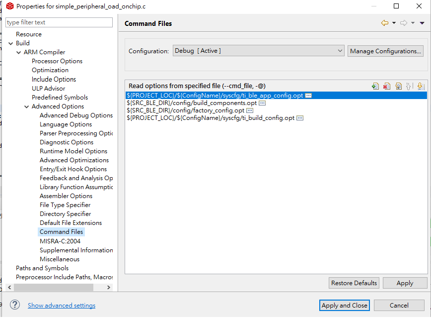

Dears,
I am using CC2642 Launchpad with SDK simplelink_cc13x2_26x2_sdk_3_30_00_03.
how to disable UART on display?
  • Hi Ming,
    If using a project that uses SysConfig, then you configure the output source using this tool.
    In the case you don't, then it should be a predefined symbol which tells you which output to use (the define is something in line with BOARD_DISPLAY_USE_*).
    You could also search the c file for the Display_open() call and set the source yourself (change from ANY to something else).
